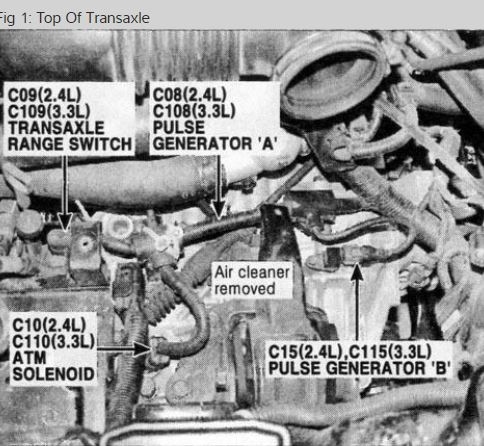

I think I need to replace the neutral safety switch. The car will not start or turn over. Radio, lights, etc. all work fine. The car for a few months would not start on occasion. If you moved the gear shift around and waited a couple minutes it would start. It got worse recently, and now nothing. I do have a replacement switch, I just don't know how to go about replacing it because I'm not sure of it's location. Under the hood or under the car, just not sure. Thanks for any help.
Mar 5, 2019 at 2:04 AM
  • 110,244 POSTS
The neutral safety switch (trans-axle range switch) is located on the top of the trans-axle. I attached a picture of its location

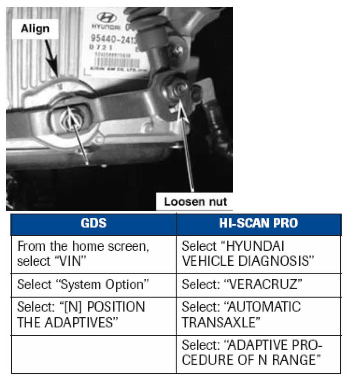

I did some digging and found if it doesn't start after switch replacement, it may need to go through a neutral relearn. This requires a scanner. I have to be honest, I have never had this happen, but under technical service bulletins, I found this. Before we assume this needs done, confirm the lever is properly positioned. See picture 1
RANGE SWITCH "N" POSITION LEARNING:
^ Stop the vehicle, move the shift lever to "N" and set the parking brake.
^ Turn the ignition switch "ON (engine off)."
^ Loosen the nut on the shift cable. Align the dot (o) on the shift lever to the "N" mark on the TCU.
Tighten the nut on the shift cable.
Picture 1

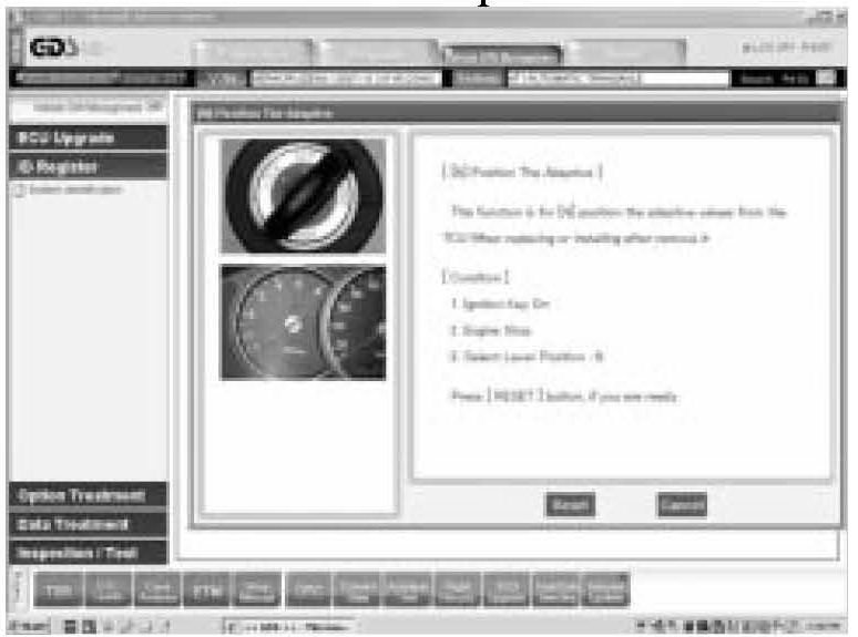

Range Switch "N" Position Learning (GDS):
Picture 2
^ Follow the instructions on the screen and confirm the test indicates "Completed."

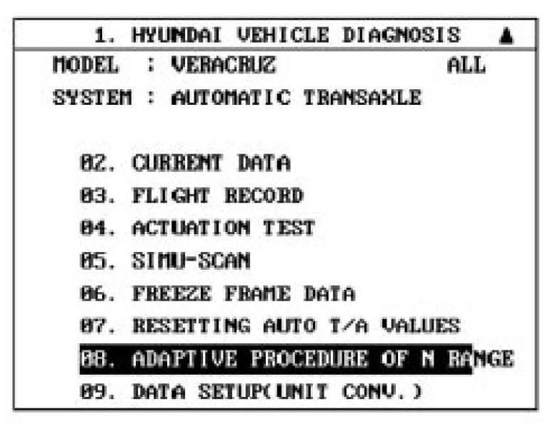

(Hi-Scan Pro):
^ Select "ADAPTIVE PROCEDURE OF N RANGE." Press "ENTER.":
Picture 3
^ Confirm the test indicates "Completed."
