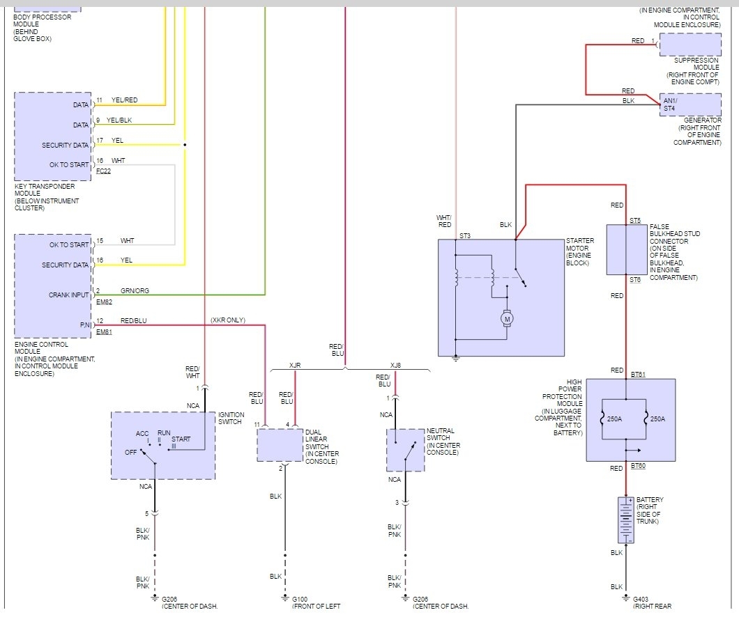

Show me the hook up for the plug connection on the car.

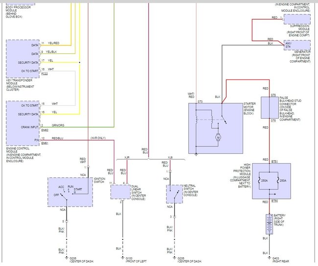

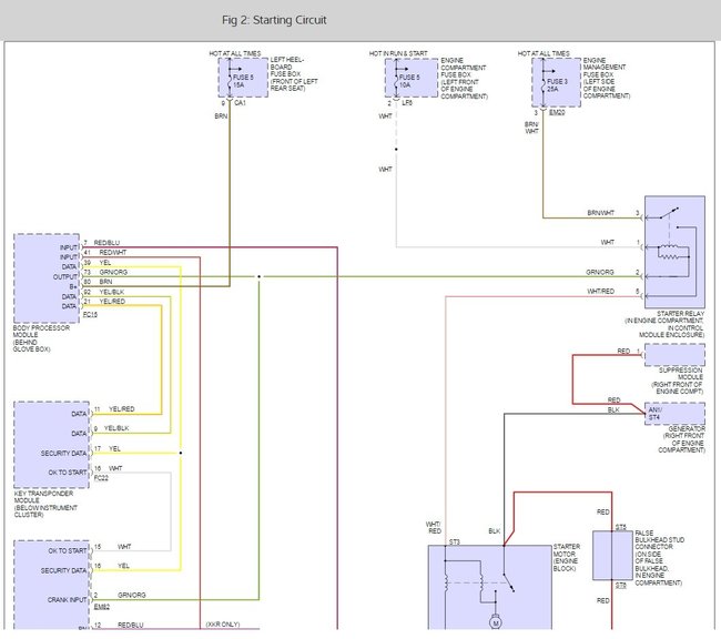

Hey HATTIE BARRETT,
Are you talking about the ALDL connector or the neutral safety switch? Is the car not starting?
Here is a wiring diagram and some guides to help you get the problem fixed.
and
and
Please let us know happens so it will help others.
Best, Ken
