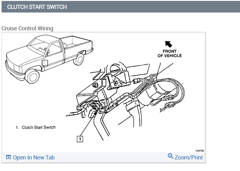

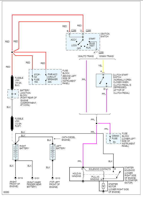

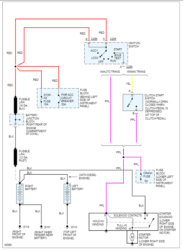

I need to know what letter wires I need to cut and connect together on my truck listed above c3500 heavy duty with a nv4500 5 speed. if you could help me out it would be greatly appreciated. thank you very much.
May 23, 2023 at 11:14 PM
  • 55,721 POSTS
This would be the yellow and purple wire at the switch, here are the starter wiring diagrams so you can see how the system works. Check out the images (below). Please let us know what happens.
