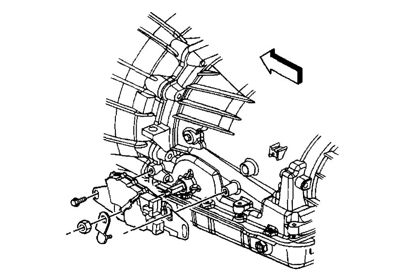

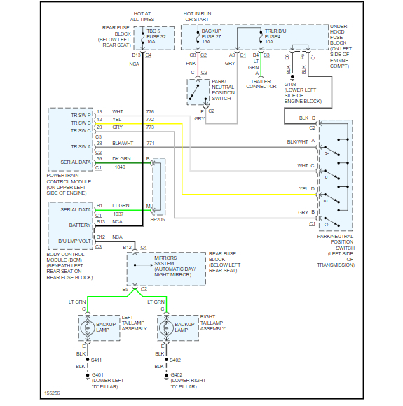

My reverse lights stopped working and auto store said sounds like neutral safety switch. could you please give me location with picture?
Feb 23, 2019 at 7:02 AM
Good morning,
Parts stores employ sales people. they are guessing as usual and need to sell you something.
There is a lot involved in the back up light circuit. I attached a picture of the location for you as well as a wire diagram with the fuse location.
I would start by doing testing on the circuit before throwing parts at it.

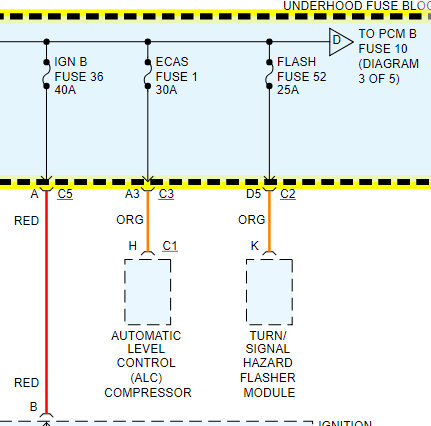

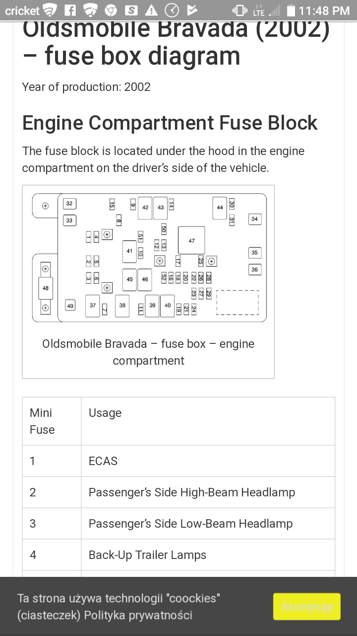

Hi, I change the neutral safety switch in the reverse lights still don't work. I have another problem the number one fuse the ecas fuse 30 amp keeps blowing. could you tell me what what would cause that?
Mar 14, 2019 at 9:35 AM
I attached a wire diagram for you for the rear back up lights. You will need a scan tool that can read the BCM as that is what sends out the power to the lights.
Test the fuses for power on both sides.
What is the ECAS you are referring to?
Mar 14, 2019 at 2:20 PM
JUNIOR JUNIOR
  • 7 POSTS
Fuse number 1 30amp keep blowing. I don't know what ecas controls.
Mar 14, 2019 at 9:01 PM
The fuse is for the auto level control system compressor.
Disconnect the compressor and see if the fuse still fails.

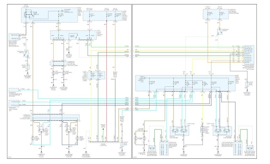

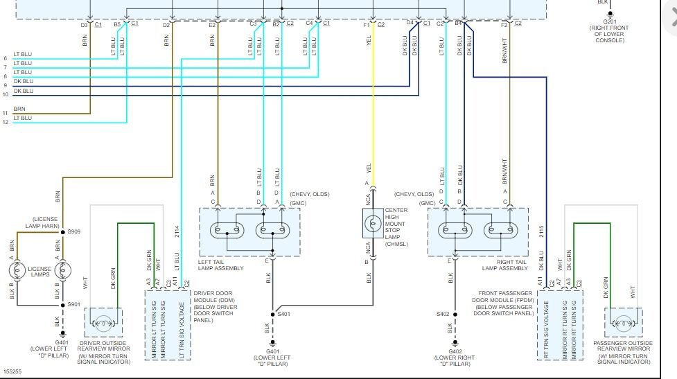

Hi Roy. I am changing tail light pigtails on 2002 Bravada but pigtail colors don't match colors on truck. Could you please send me a color code diagram? Thank you
Apr 19, 2019 at 3:45 AM
Okay, I attached a diagram for you for the back up lights a while back. It shows a light blue wire for the back up lights.
attached is the diagram for the other lights.
