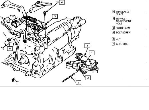

Neutral safety switch location
1991 CHEVROLET CAVALIER
139,000 MILES • 4 CYL • 2WD • AUTOMATIC
ALLEN IVANOFF
Where is it located and difficulty changing it from one to ten?

It is on the shift lever on the transmission. Must be in "neutral" when installing a new switch that is pinned in neutral. If the pin is broken, or an old switch is being reinstalled, there is a procedure that involves dropping a pin in the hole to hold it in adjustment while the mounting bolts are being tightened.
