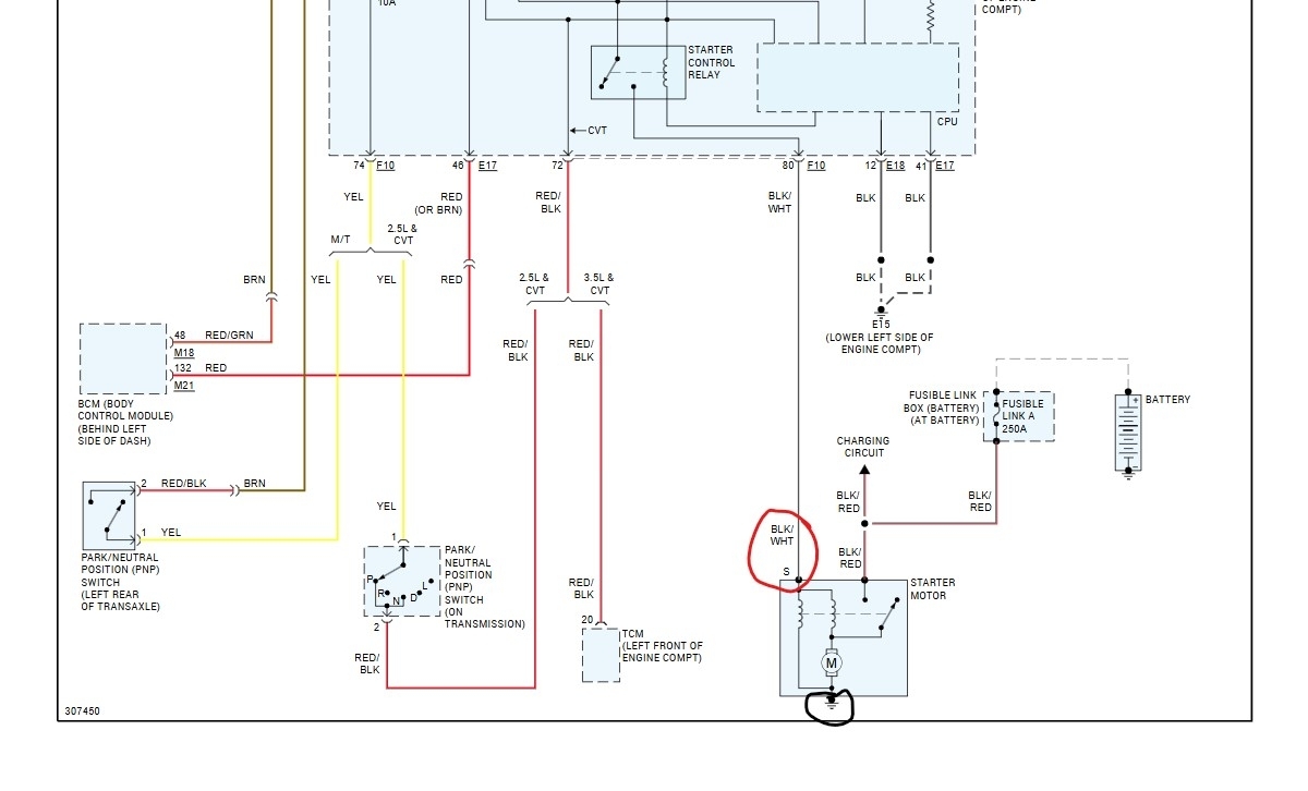

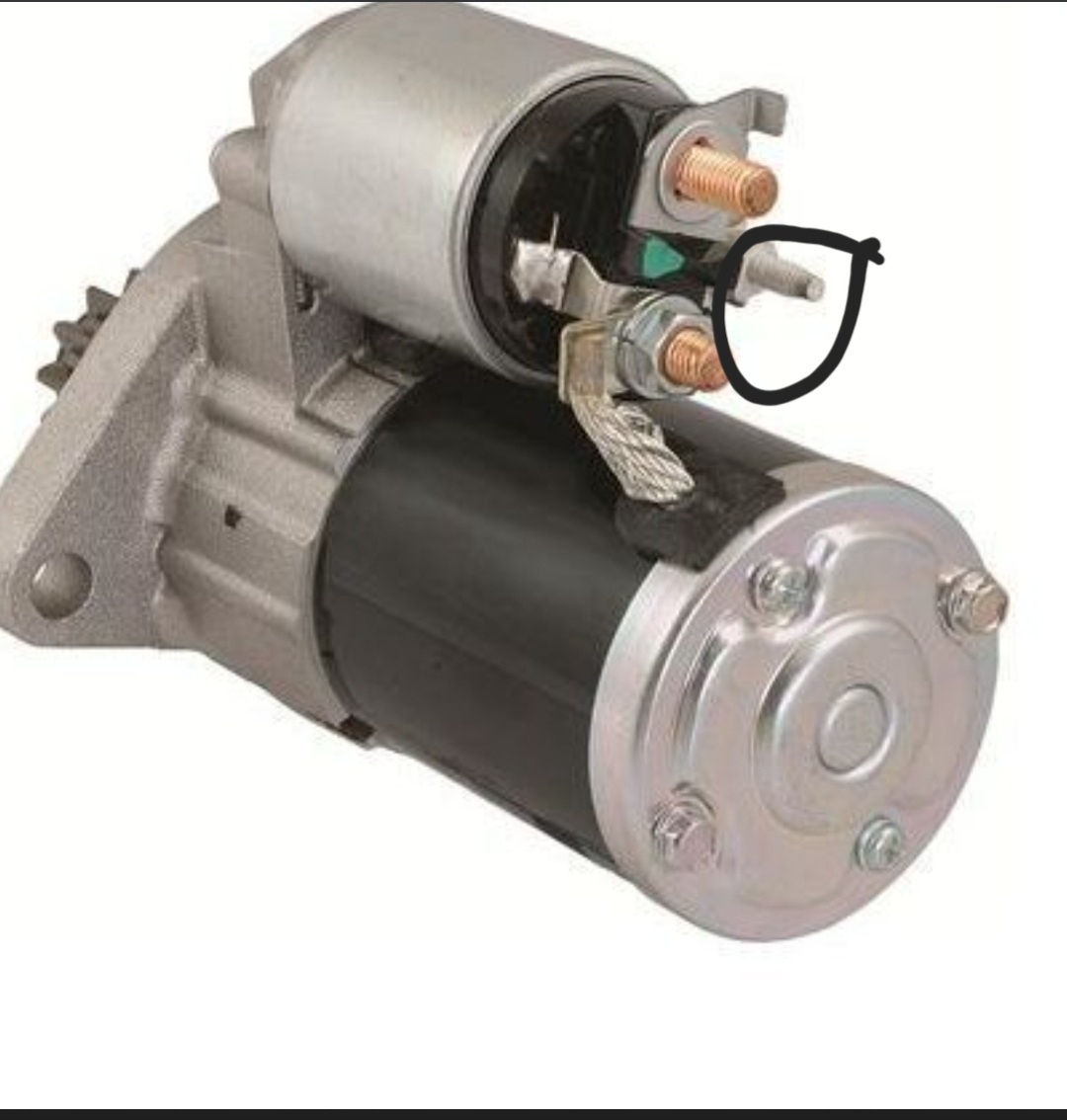

Unfortunately the car doesn't run. I haven't been testing a wire exactly I've attached a picture showing what's showing - 12 volts. I'll definitely try a voltage drop test when I get home and purchase a test light.

OK you put the positive lead on the meter on that, then touch the negative lead to a ground point, you should see 12 volts when you turn the key. with the Black w white wire connected to that post. If you are testing without that wire in place and see -12 then you have a bad connection that is causing voltage drop and that is what the meter sees. FYI, you want the old style "scope on a rope" tester, not the newer LED types, those have their place but the good old bulb types are far mor effective for testing.
