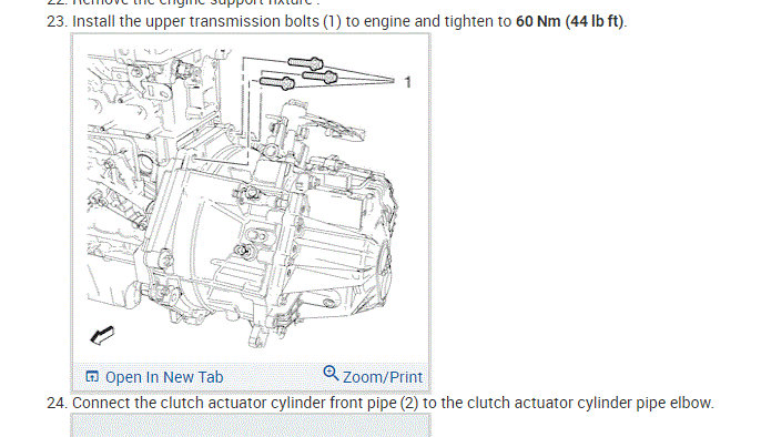

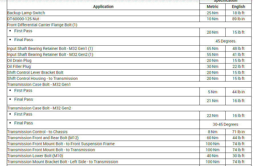

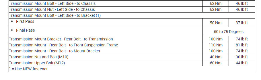

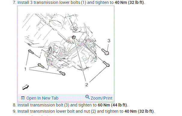

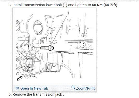

Replaced my clutch and cant seem to be able to find the transmission bolt torque specs in my book. any help would be greatly appreciated. I've looked everywhere, kind of thinking I should just tighten them as much as I can and call it.
Oct 5, 2020 at 2:27 PM
Good evening,
I attached the torque spec chart for all the bolts on the transmission.
I also attached the torque for the bell housing bolts as they have different torques based on location.
