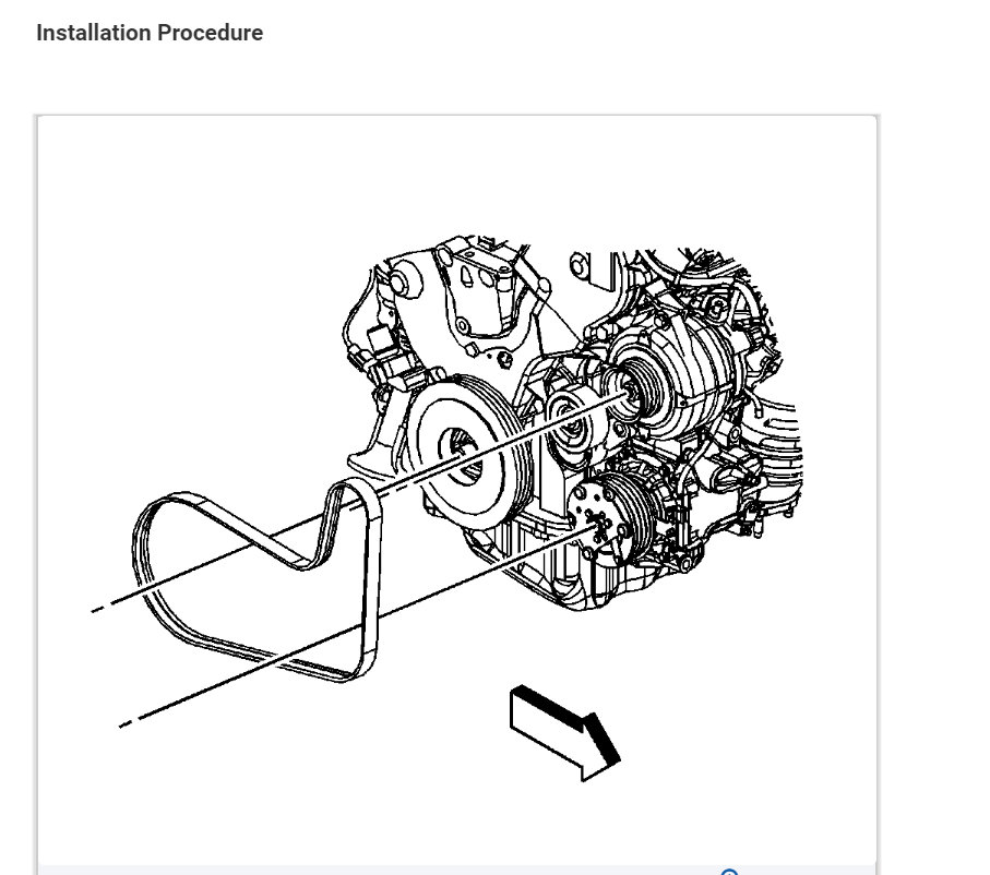

I changed the alternator on my vehicle but didn't show the belt was put on. can I get a diagram please?

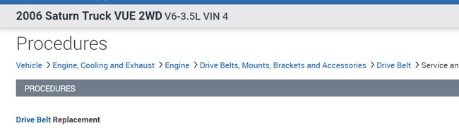

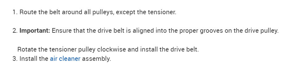

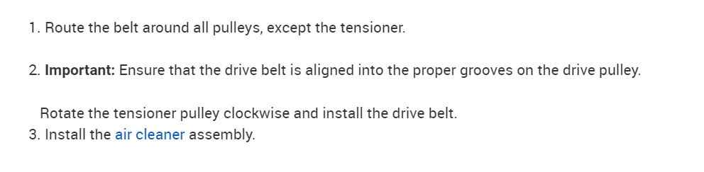

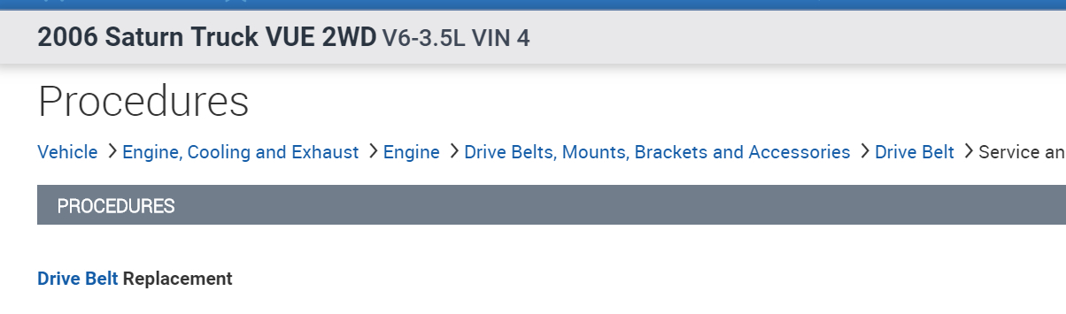

I have included the information that you requested in the diagrams down below. Please go through this factory guide for the installation of your vehicle's drive belt and please get back to us with how everything turns out, or if you should have any other additional questions or concerns.
