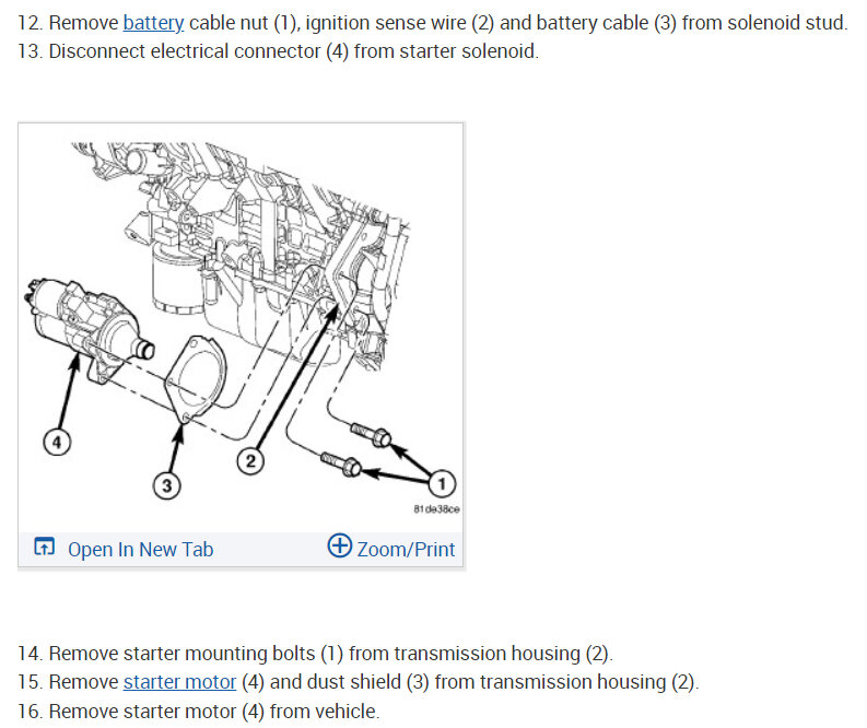

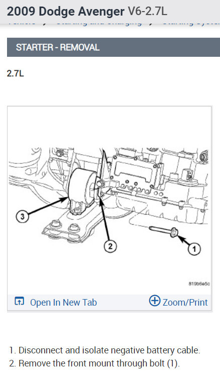

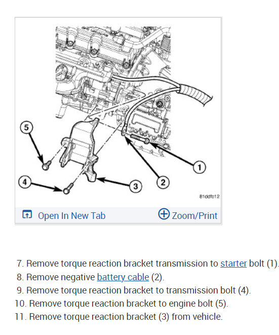

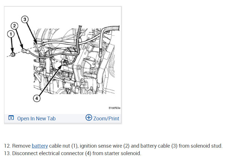

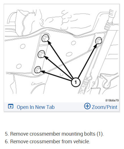

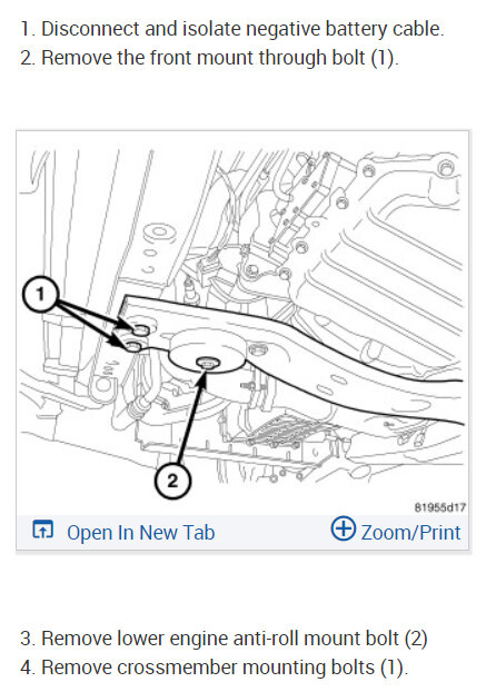

need wiring hookup at the starter. have 2 wires and a connector, and cannot remember where the 2 wires go.
Jan 27, 2024 at 1:47 AM
  • 55,402 POSTS
Here is how to remove the starter and it shows where the wires go. Check out the images (below). Let us know if you need anything else.
