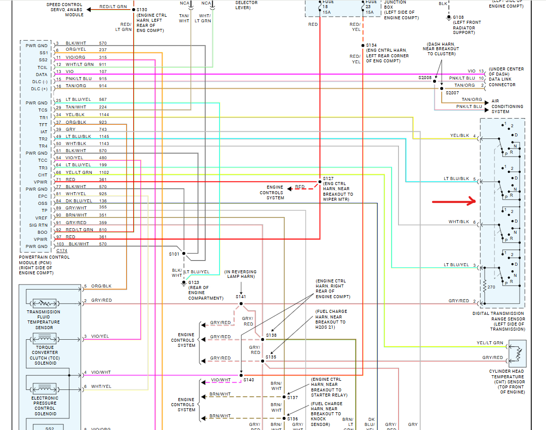

Need wiring diagram for transmission range sensor for Ford 2000 expedition
2000 FORD EXPEDITION
150,000 MILES • 5.0L • V8 • 4WD • AUTOMATIC
LEOPOLDOC
MEMBER
3 POSTS
The old wiring is burnt I have a new plug but there are no colors on the wires.
Dec 28, 2025 at 4:42 AM
Experienced Mechanic
55,628 POSTS
Sure, here is the wiring diagrams for the digital range sensor. Check out the images (below). Let us know if you need anything else.
