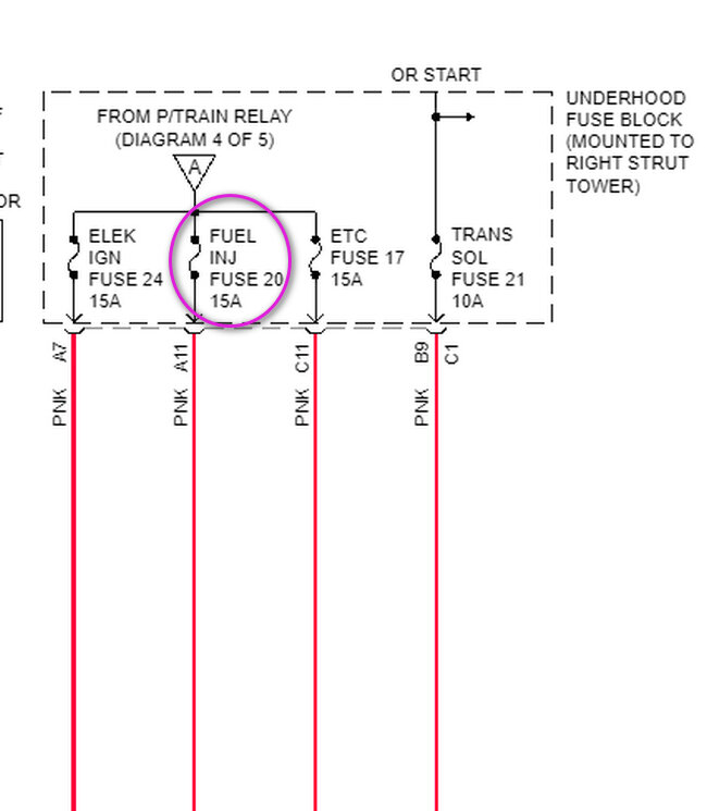

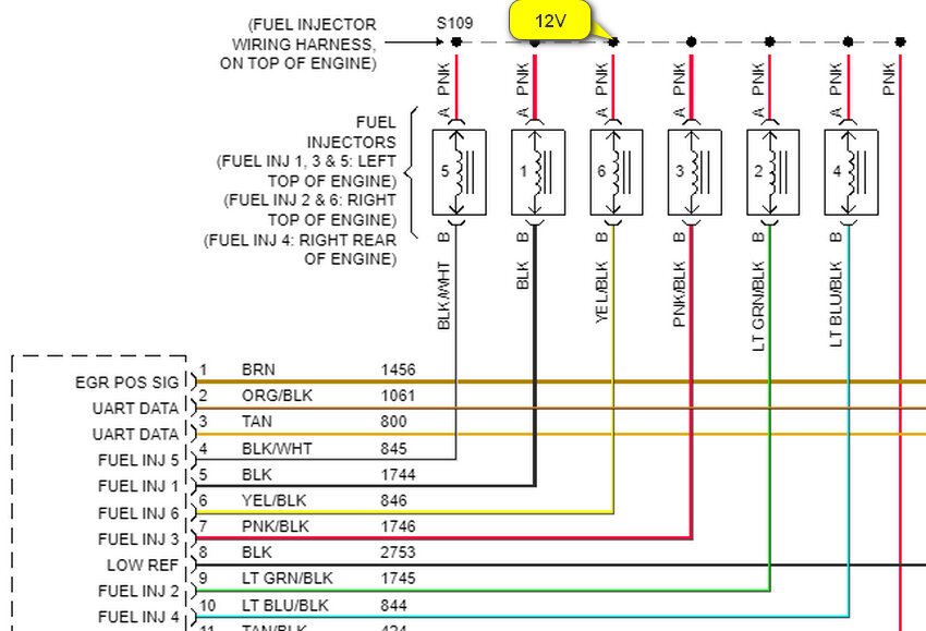

Can I get the wiring diagram for the ECM and injectors?
2005 PONTIAC GRAND PRIX
220,000 MILES • 3.8L • 6 CYL • 2WD • AUTOMATIC
MSTHITZ3
Replaced the crankshaft position sensor and now it's throwing a code that none of the injectors are firing. It cranks but does not turn over. Don't know if the ECM or injectors are bad? Going to test the injectors with a Noid pulse light.

Suggest to first check that fuse F20(15A) in the under-hood fuse block is still intact.
See diagrams below.
How to check:
If fuse is in order next check that you have 12V ignition supply at each injector at pin A, pink wire.
This can be done using a test light or voltmeter.
