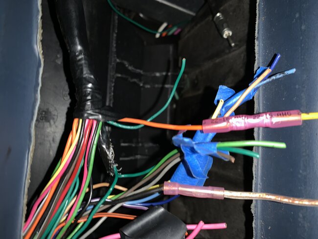

I try to get a description, but I need but I don’t think I did it right. basically, I have some cut wires. Where are you hook up the aftermarket stereo and I believe one or two these wires don’t connect to the car stereo here’s a picture. the one green and one of the pink wires.

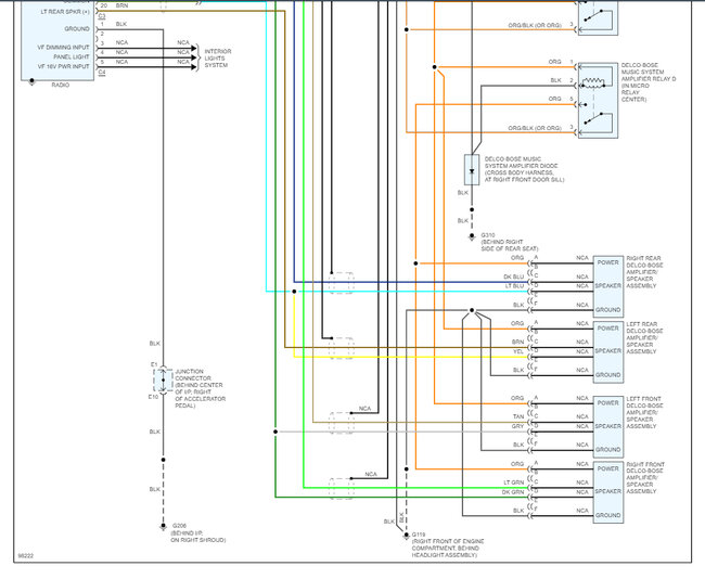

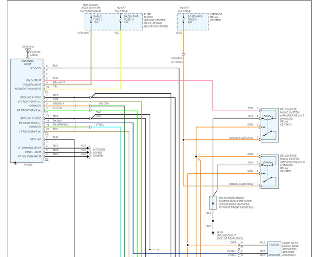

Here are the wiring diagrams for the radio as requested and i have included a guide to help you check the connections.

Thank you, what is nca wires mean ground or what?
May 2, 2023 at 5:16 AM
  • 55,381 POSTS
NCA means there is no color assigned.
