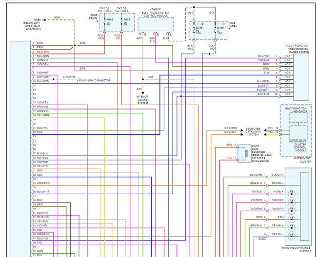

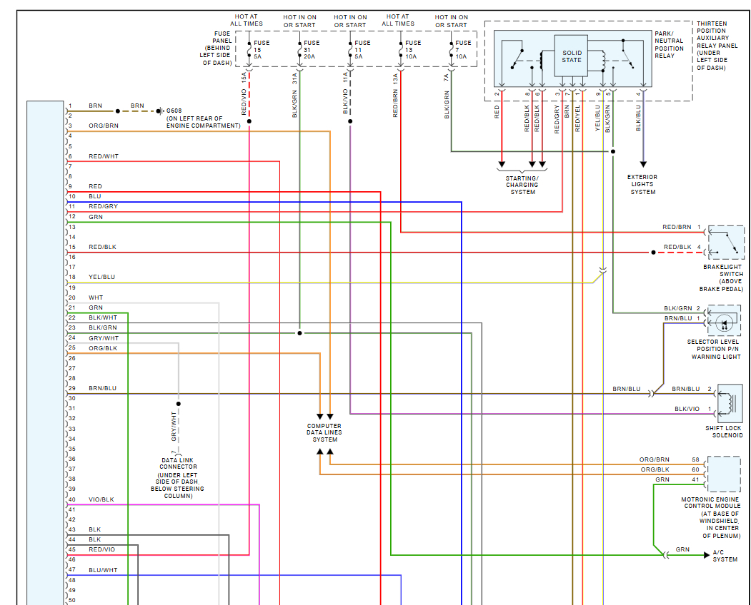

Transmission and gear selector wiring diagram need?
2006 VOLKSWAGEN JETTA GLI
200,000 MILES • 2.0L • 4 CYL • 2WD • AUTOMATIC
SECONDJOHN
  • 12 POSTS
Transmission and gear selector wiring diagram?
Feb 11, 2025 at 6:48 AM
  • 55,399 POSTS
Sure, here are the wiring diagrams for the transmission (6 speed) and range display as requested, also I included a guide to help you check the wiring.
Feb 12, 2025 at 2:02 AM
SECONDJOHN
  • 12 POSTS
Thank you. I've already checked the gear selector end, have seen +12, ground, and CAN hi and CAN lo with a scope, so now I can pursue them to the transmission controller.

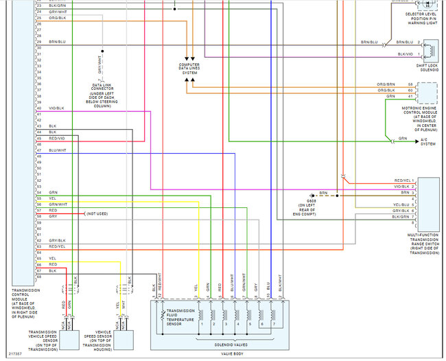

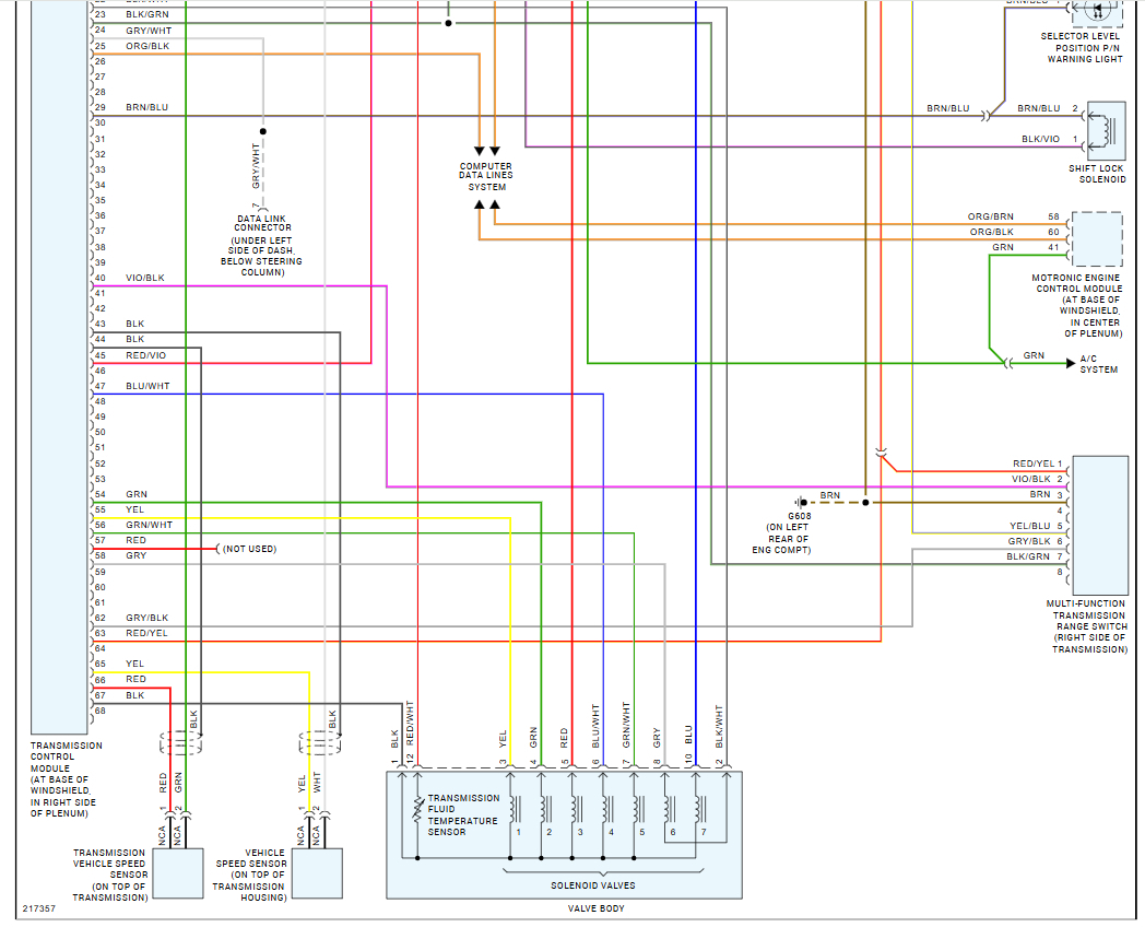

Feb 12, 2025 at 7:45 AM
  • 55,399 POSTS
I would check the TCM electrical connector for corrosion, which is common, it is located behind the left front wheel well.

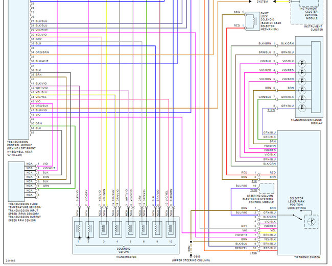

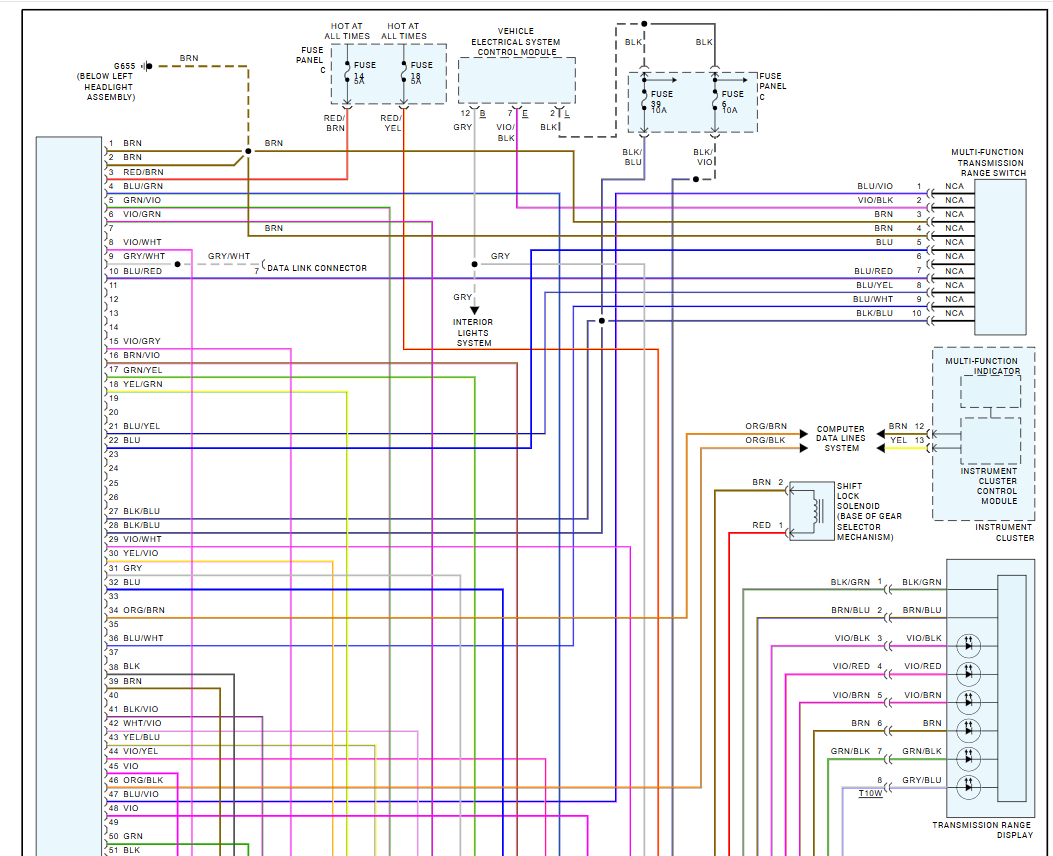

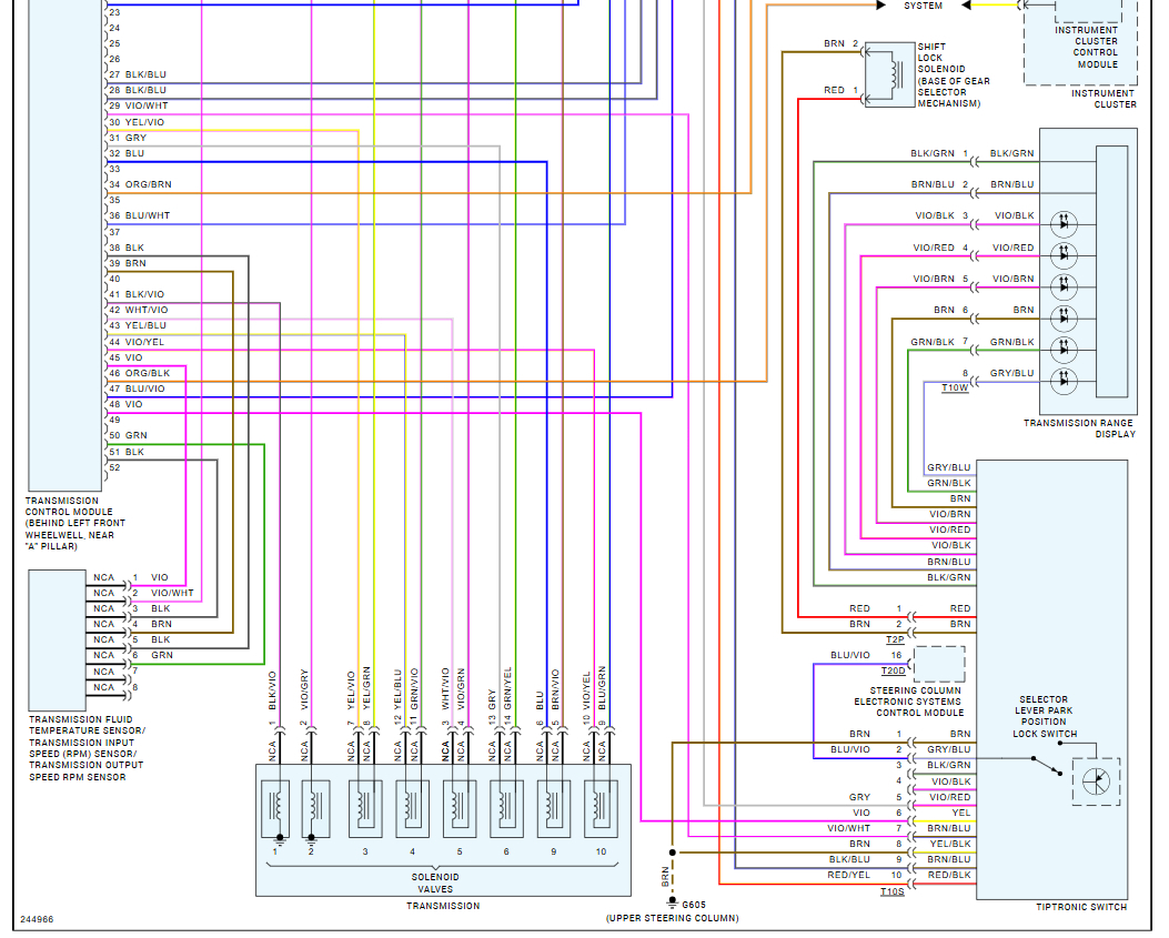

I just realized that I may not have specified 02E DSG. Are these cables from the DSG gear selector the same as for other transmissions?
Feb 13, 2025 at 6:24 AM
  • 55,399 POSTS
Here are the wiring diagrams for that application. Check out the images (below). Please let us know what happens.
Feb 14, 2025 at 2:35 AM
SECONDJOHN
  • 12 POSTS
Thank you, thank you very much. All of these diagrams have helped. I cleaned up my gear selector codes and now have a couple more to knock out, but you are providing a nice service.

The schematics I had already verified for the gear selector had +12, Gnd, hi and lo CAN bus. What else is there, right? There was a second +12 input on the schematic that I wasn't aware of, and (somehow) the fuse to that lead was absent. That cleared up the transmission problems before I dug too deeply into that. I think the inertia and yaw sensors may clear up when I do some driving and re-initialize some initial adaptations. But I'll at least get the car back on the road.
Feb 15, 2025 at 3:26 AM
  • 55,399 POSTS
Was there a problem that you fixed and if so, what was it?
Feb 17, 2025 at 12:40 AM
SECONDJOHN
  • 12 POSTS
I supplied the second +12 that I didn't know existed. Also, replaced the connector shell, which had a broken tab that held the mating connector in place. This should eliminate the "cannot communicate with selector" error.
