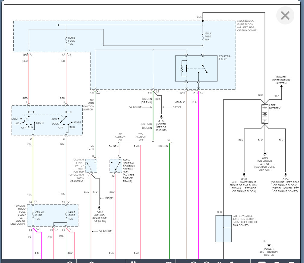

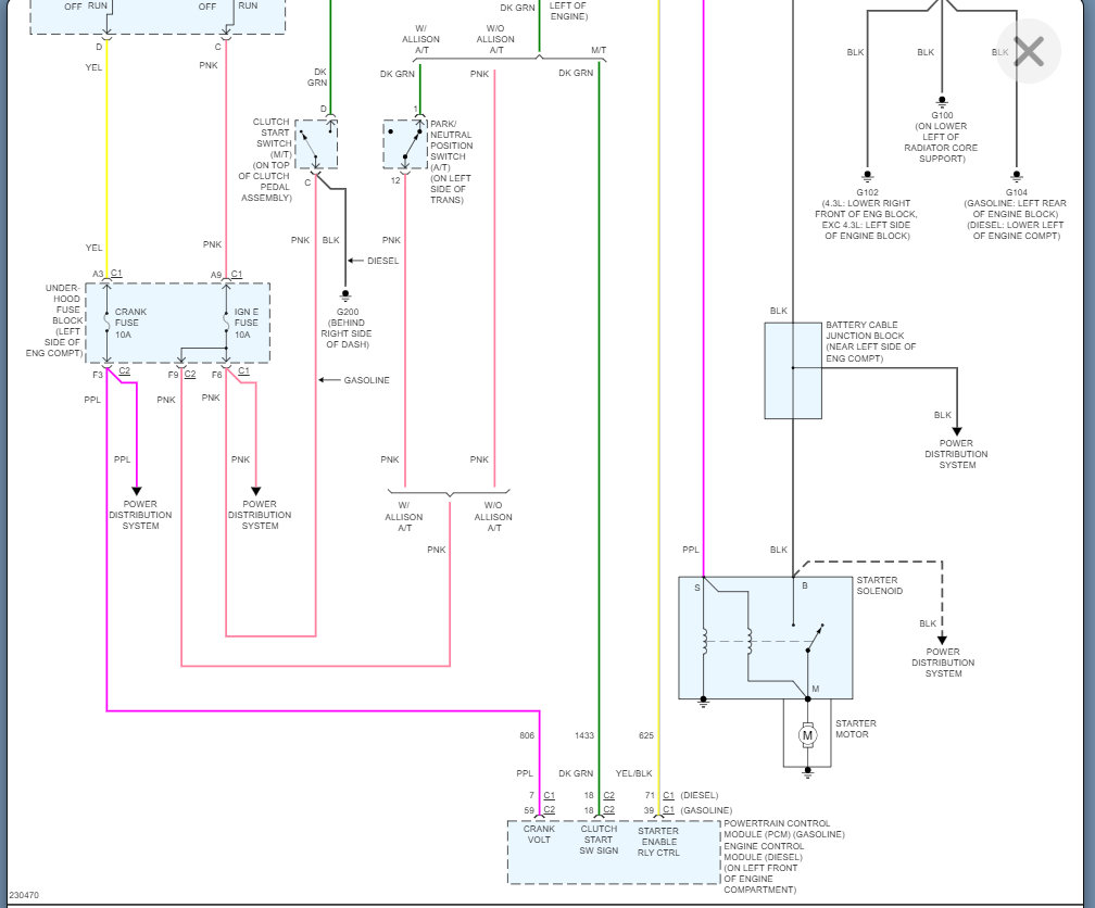

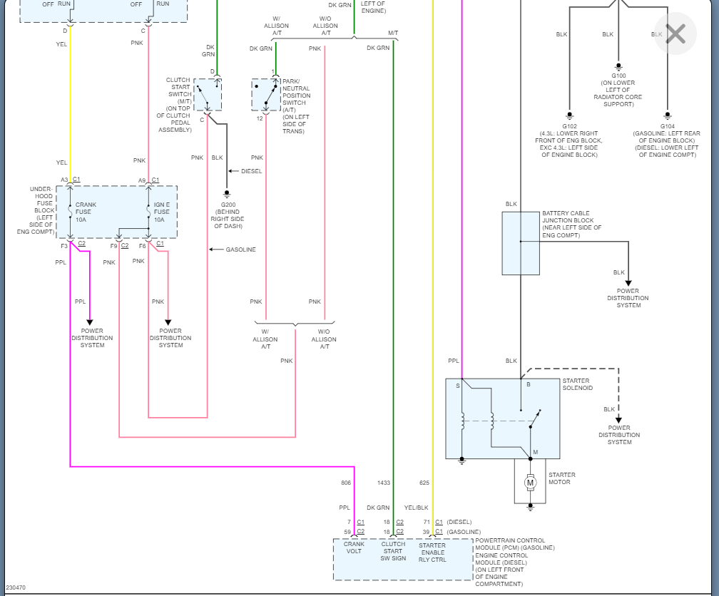

I am attaching the wiring diagram of the starting system which is usually all you need for these systems, but I am not familiar with this specific system so let us know if you need other diagrams and we can supply them.
However, we need to know what system you are needing because they don't supply wiring diagrams based on what is getting installed.
Here is a guide that will help if you need to do any testing on these circuits to get it installed:
Please see the diagram below and let us know what else you need.
