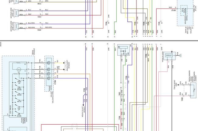

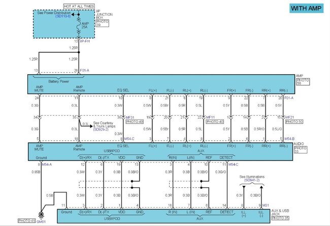

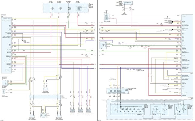

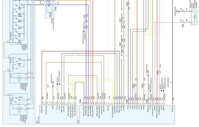

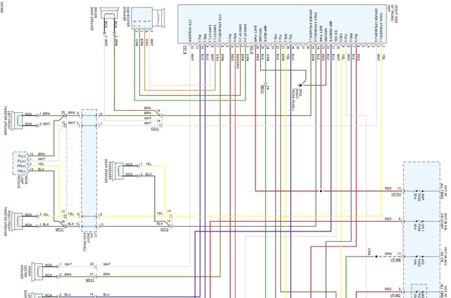

I need to know the correct order for the wires to connect them back to the pin to connect back to the 8-channel amplifier. Connector B.
Mar 13, 2025 at 3:59 PM
STEVE W.
  • 15,394 POSTS
This is the full wiring for the audio system with amp. Should cover the wiring you need.

Got a new head unit, and I messed up and pulled some wires out of the 26 pin connector harness and I didn’t made a record of what when where. Now my speakers are not functioning due to the fact that some wires are in incorrect positions I have like 3 wires I don’t know where they go and can NOT find anything online of a picture with COLORED connections for my specific make and model vehicle.

Yes! Sorry it took so long to respond! Issues with login. But it took me a matter of minutes to get everything back to where it was supposed to be. Spend hours scouring the internet trying to find the right one. You’re a life saver.
