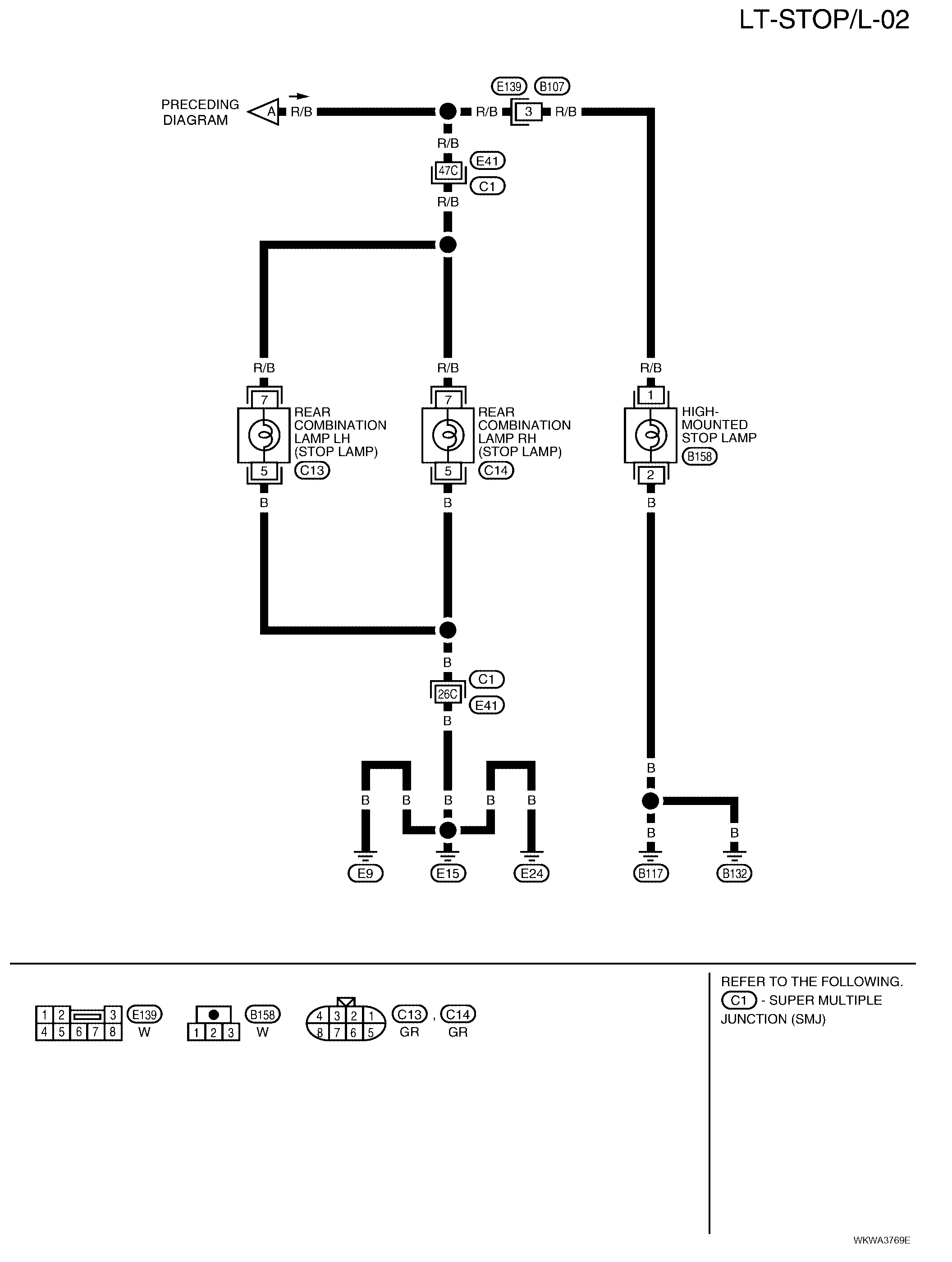

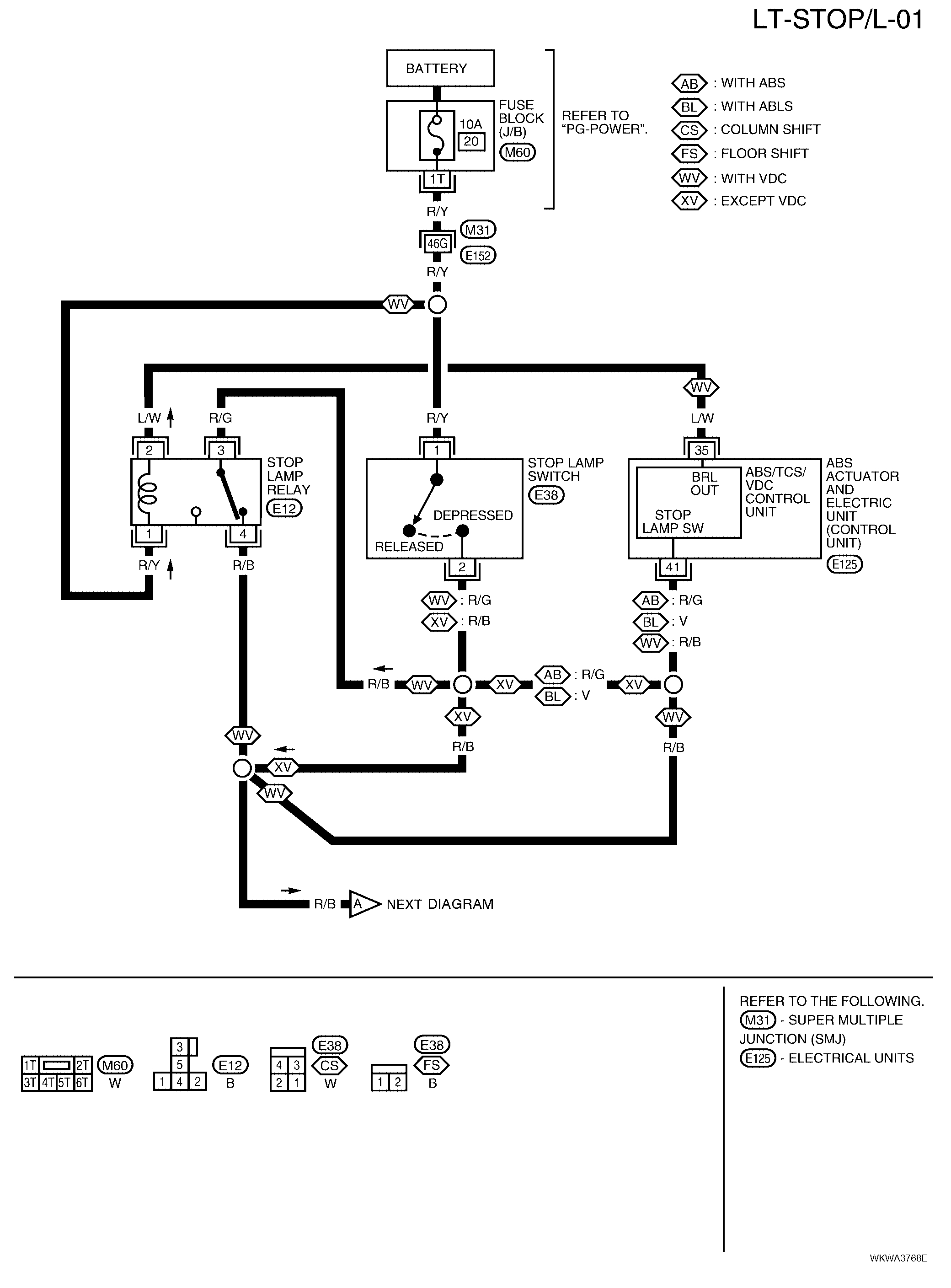

Not getting power to brake pedal switch. Relay is good. Power on both ends of good fuse.
Aug 30, 2026 at 1:52 PM
KRAKENAUTO
Experienced Mechanic
114 POSTS
Trace the incoming power wire (usually Red/Yellow) back from the switch to check for a broken wire, corroded connector, or open fuse block connection.
The wiring diagrams are attached for the brake lights.
