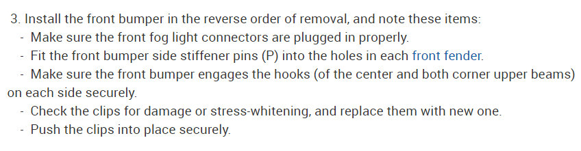

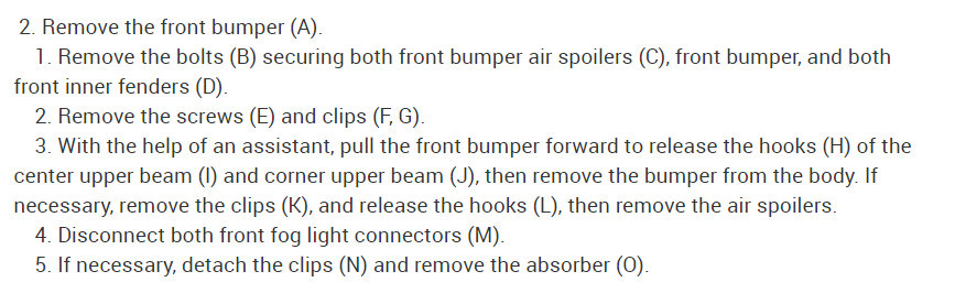

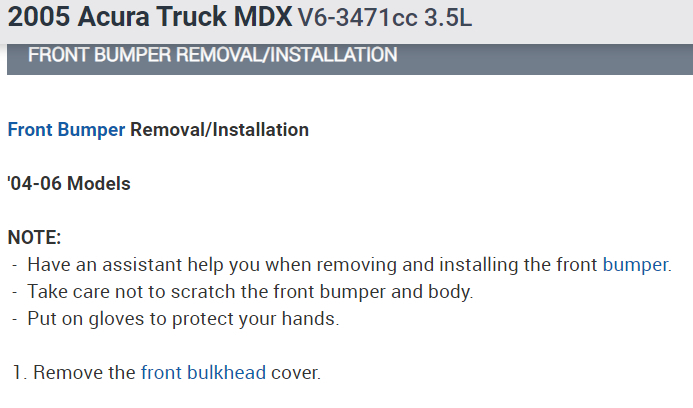

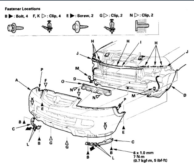

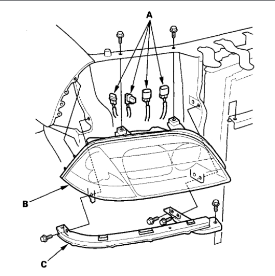

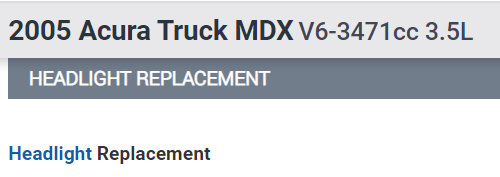

Need video to remove and replace the headlights for the vehicle listed above.
Sep 27, 2014 at 11:35 AM
DANNY L
Experienced Mechanic
5,648 POSTS
Hello, I'm Danny.

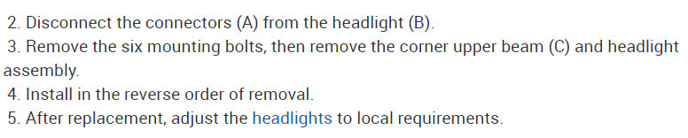

Here is a tutorial on how to replace headlight bulbs for an Acura MDX.
https://youtu.be/T9zoLXkaRQg
I've attached picture steps below on how to remove the front bumper to gain access to the headlights to remove and replace.
