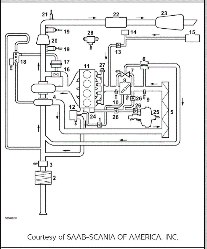

Having surging issues. Replaced sparkplugs, coils, clean various electrical connectors (H32?), removed/tested waste gate solenoid, tested/replaced WG actuator, Evap solenoid. Vacuum pump is good. Decided to replace all vacuum lines under the hood: 1) To guarantee no leaks, and 2) To be sure they are routed correctly. Hence, I need a diagram. Car is 20t Linear.
I have not checked fuel pressure for consistency because replacing filter is difficult, I have to drop tank as the American version of this car has filter inside tank.

For some reason, the vacuum schematics are very difficult to find. However, I did attach what I was able to locate.
If you look at pic 1 below, it is a schematic of several components but also included the EVAP system and routing. The remaining pics are the legend for the components in the picture.
Take a look through this and let me know if it helps.
