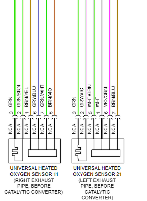

The connector for upstream o2 sensor (bank2) was cut off due to a recent accident. Can someone help me with the layout of the connector? something like attached pic will be helpful.

Please see pin out in image below.
Pin 1, white wire
Pin 2, grey/violet wire
Pin 3, green wire
Pin 4, not used
Pin 5, white/green wire
Pin 6, violet/green wire
Pin 7, brown/blue wire
Cheers, Boris

thank you for the help. it worked !!
