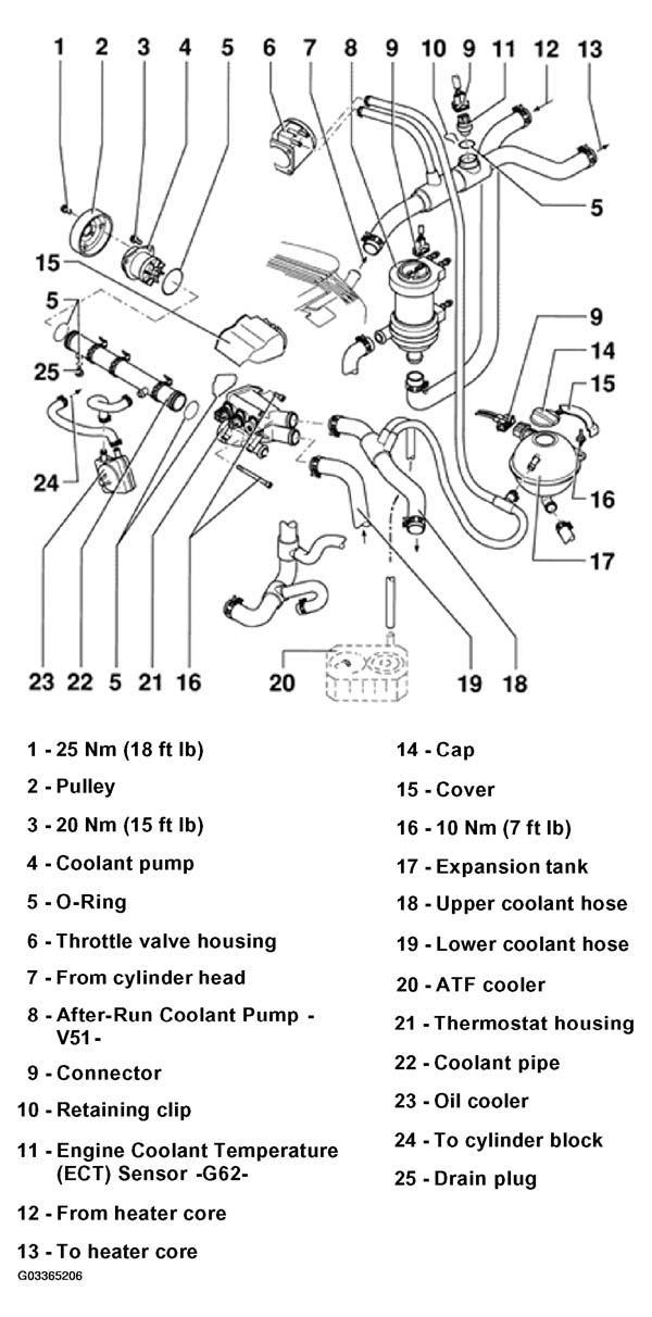

Need to see a picture to see how all hose go in a vr6 1998

TOOK OFF ALL THE HOSES AND FORGOT THE WAY GO ON

This is about the best I can find that shows hose locations, I hope that it helps.
