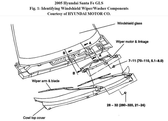

I need to replace the wiper linkage / transmission on this car for my daughter. The spline has stripped on the drivers side. How do I remove the body panel to get to the motor linkage assembly.
Thanks in advance
Don
Apr 29, 2013 at 12:16 AM
KHLOW2008
  • 41,814 POSTS

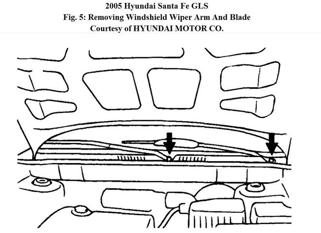

1. Remove the windshield wiper arm and blade.
NOTE:
Care must be taken not to scratch the engine hood.

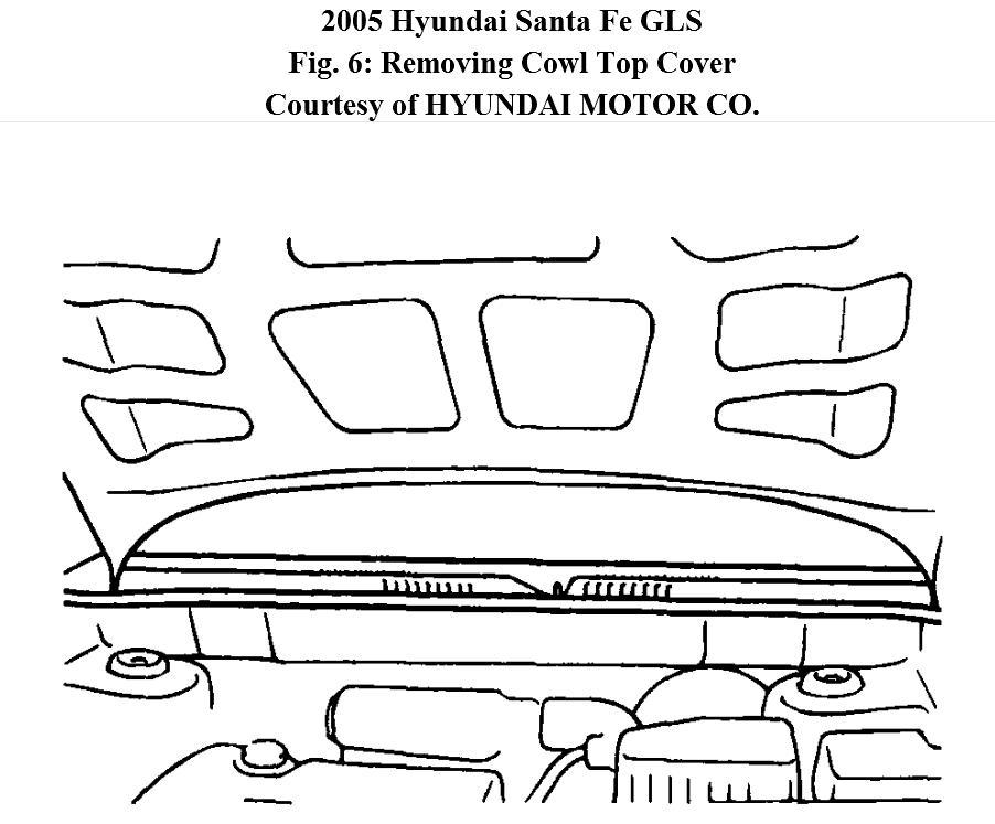

2. Remove the weather strip and the cowl top cover.

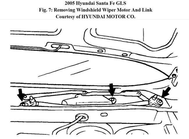

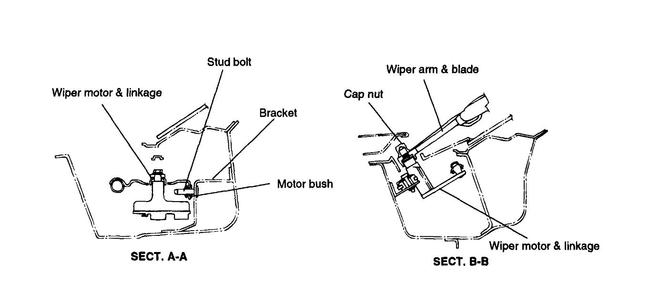

3. Disconnect the windshield wiper motor connector and remove the windshield
wiper motor and the link.
Tightening torque
7~11 Nm (70~110 kg.cm, 5.1~8.0 lb.ft)

One more question if you would be so kind.
Looks like 4 clips(?) hold the cowl on the engine side. Haven't seen the car yet to examine. She is bringing it over tonight
Thanks in advance
Don
Apr 29, 2013 at 4:02 AM
KHLOW2008
  • 41,814 POSTS
Sorry I don't have information on the number of clips.
