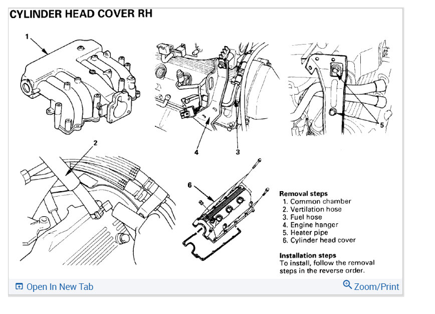

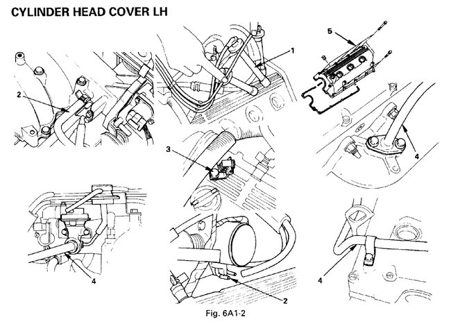

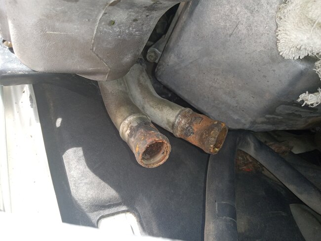

Okay, I was replacing my spark plugs and when I took off the wires, I had oil pouring out of the holes and the spark plugs were just dripping with oil. so, I got the valve cover ready on the driver's side but the left side when looking at motor I can't figure out how to get the lines out of my way to get the cover off without messing up my valves. please help. thanks for the reply.

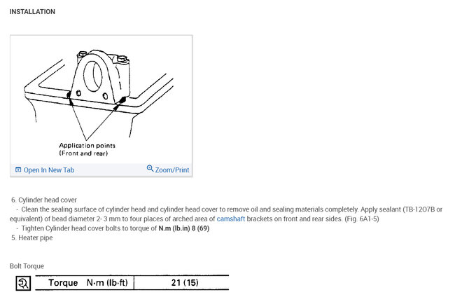

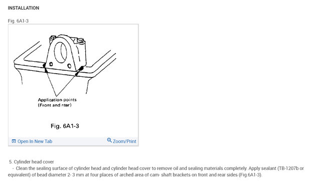

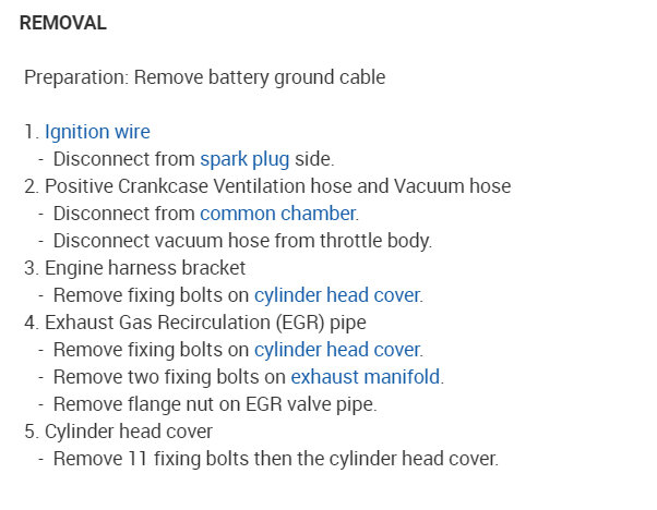

The picture looks like heater hose? I am not sure what you are saying. Can you please upload more images of the problem? Here is the instructions on how to replace the valve cover gasket in the images below. Check out the images (below). Please let us know if you need anything else to get the problem fixed.
