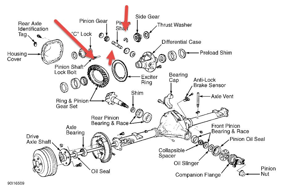

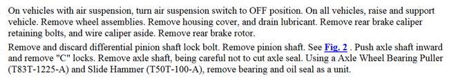

Need to replace rear axel bearings
1996 FORD F-150
200,000 MILES • 5.8L • V8 • 4WD • AUTOMATIC
TODD WINNEGA
I have slop in the bearing on right side and seal has oil all over brakes and tire.
