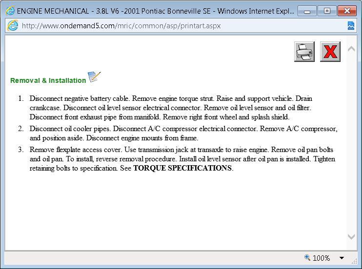

How labor intensive to replace the oil pan in hours? I can' scrap it now just stuck 800. in car and poked a hole in the oilpan with my jack. It slipped. Cast alum. oil pan can be bought cheap....... what about labor???

The book calls for 1.9 hours to remove and replace. Let me know if you have other questions.

Hears the instructions for replacing the oil pan.
