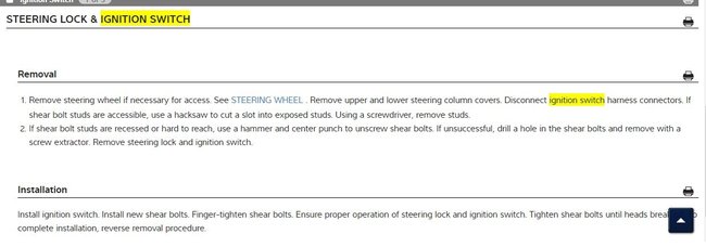

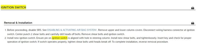

Hi, I have the car listed above GXE model. I want to know how do I remove my ignition starter switch that is behind the lock cylinder? do you have a diagram?
Feb 16, 2019 at 10:06 AM
  • 110,244 POSTS
Welcome to 2CarPros.

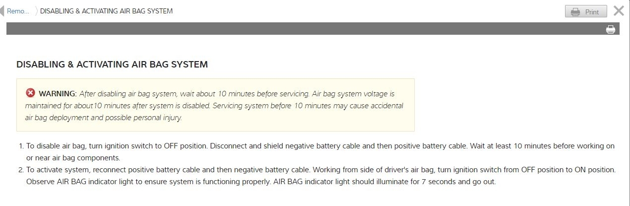

The directions for replacing the ignition switch are located in pictures 1 and 2. I had to provide them this way. Before you start working on it, follow the directions in picture 3 to disable the air bag.
