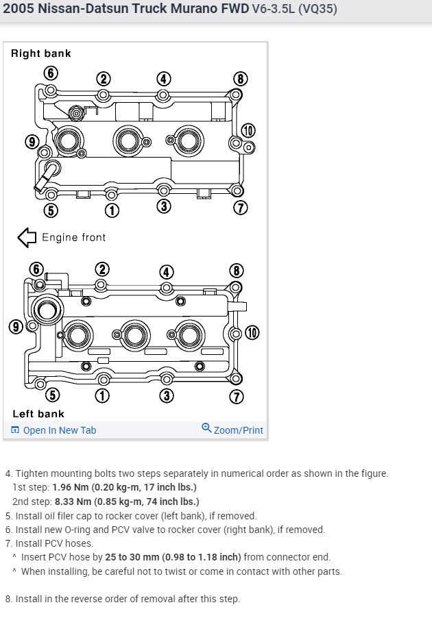

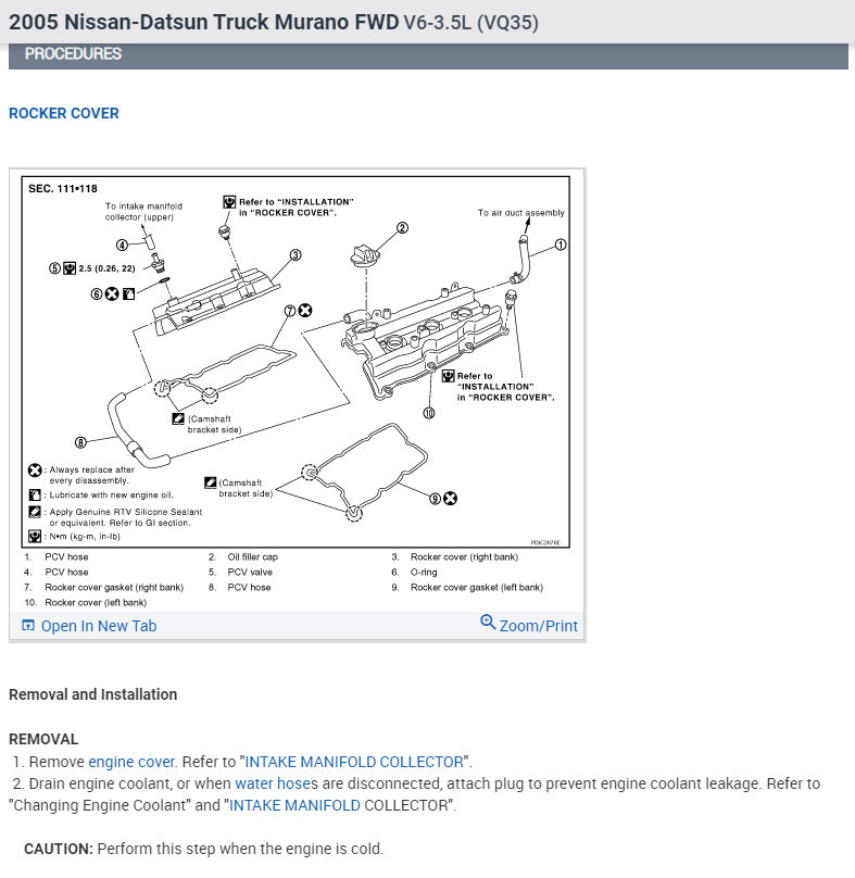

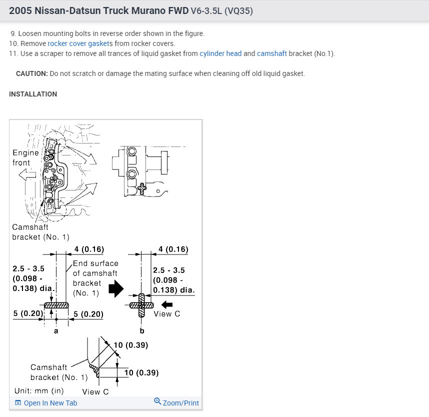

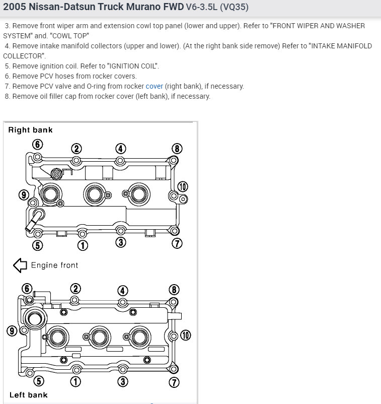

Need to remove and replace both valve gaskets.
Apr 18, 2022 at 10:30 PM
SQM
Experienced Mechanic
6,383 POSTS
I have attached the valve cover gasket replacement procedure below, including the torque specifications.
Let me know of any questions.
https://www.2carpros.com/articles/replace-valve-cover-gasket
