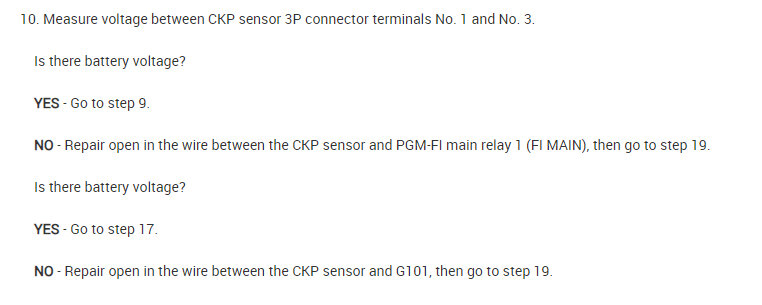

My vehicle listed above got a code for the upstream oxygen sensor. Replaced it now engine will not start and when it starts it stops right away will not run. I put a new crank sensor, new timing chain and gears, now it will start and run for a little while, but then it will stop and shut off and it will not start again until the engine is cold. Now I am trying to check the sensor. I had put a new crank sensor I want to check the cam wiring and the crank wiring to see if the values are right or if there’s a short anywhere in the loom. thank you
Jun 10, 2024 at 11:26 AM
  • 110,244 POSTS

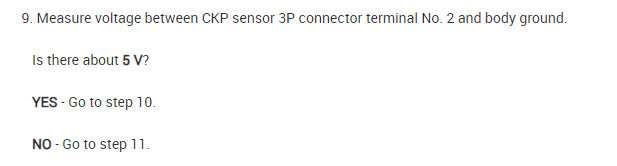

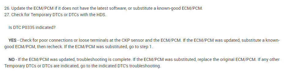

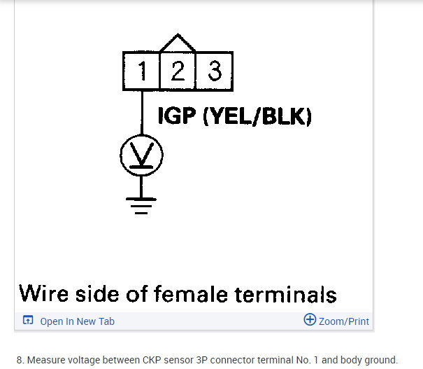

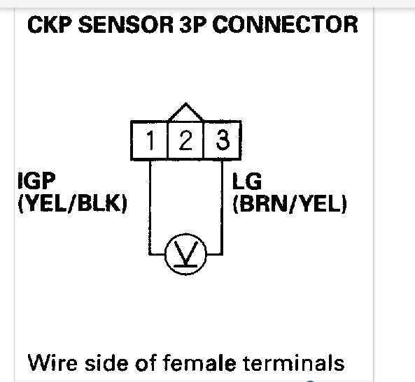

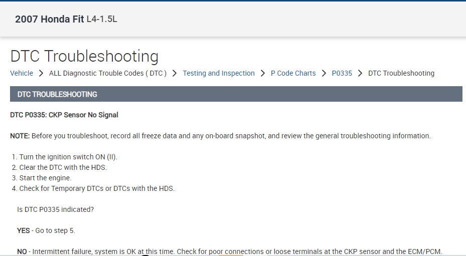

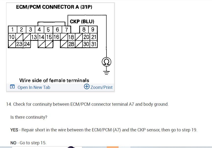

As far as testing goes, do this first. When the engine stalls and won't restart, see if it starts if you use starting fluid. If it does and then stalls, we have a fuel related issue. If there is no change, check to see if there is spark to the plugs.
Here is a link that explains how that is done:
https://www.2carpros.com/articles/how-to-check-for-ignition-spark

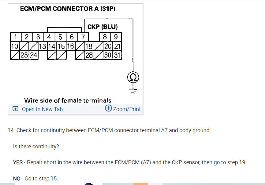

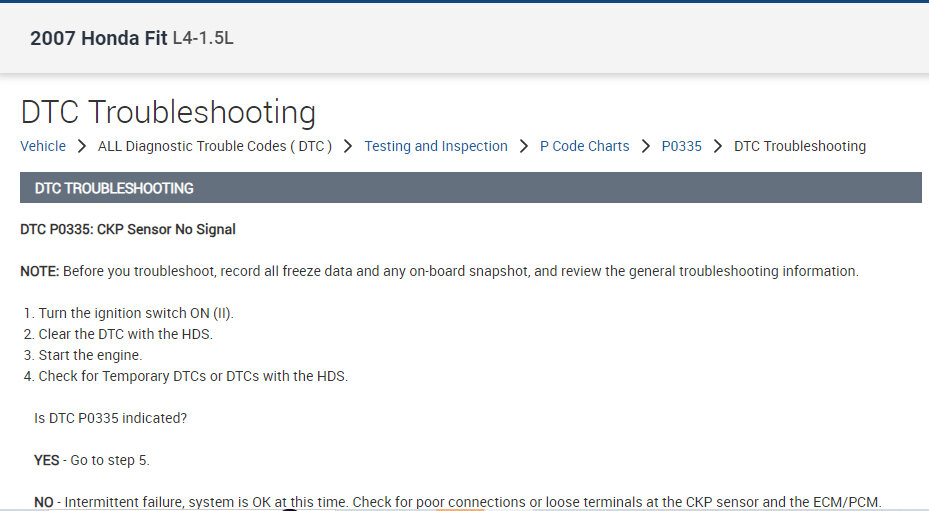

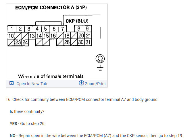

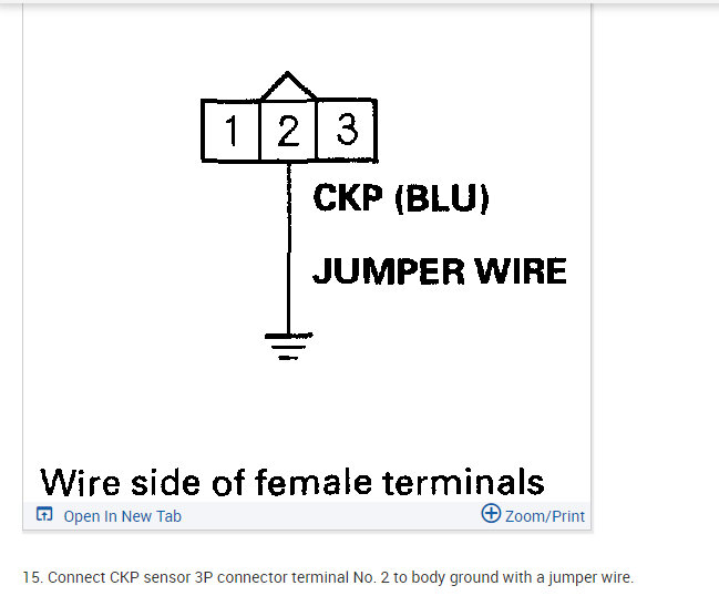

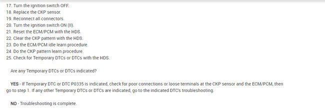

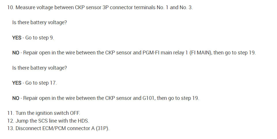

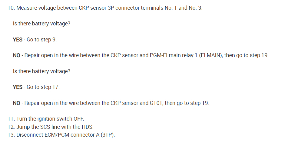

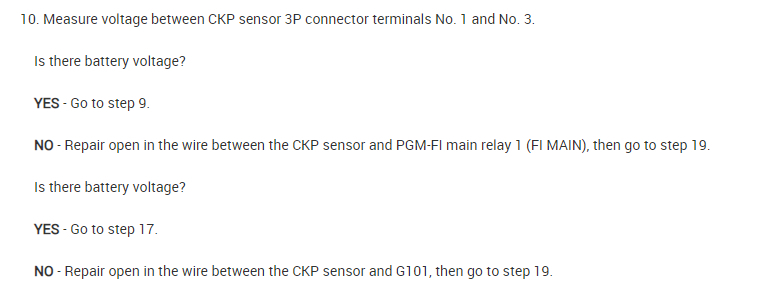

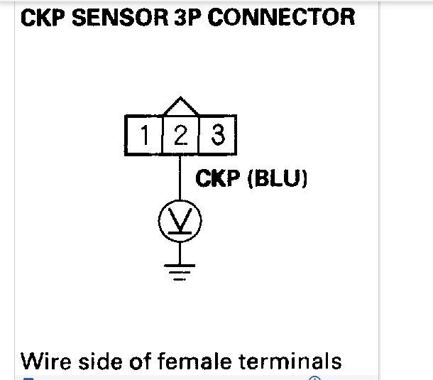

Next, I attached the diagnostics below for the crankshaft position sensor. The diagnostics are for a no signal condition, which would prevent the engine from starting. As far as the camshaft sensor is concerned, I'm running into trouble finding the same info. By chance, are there codes stored that would point me in the right direction?

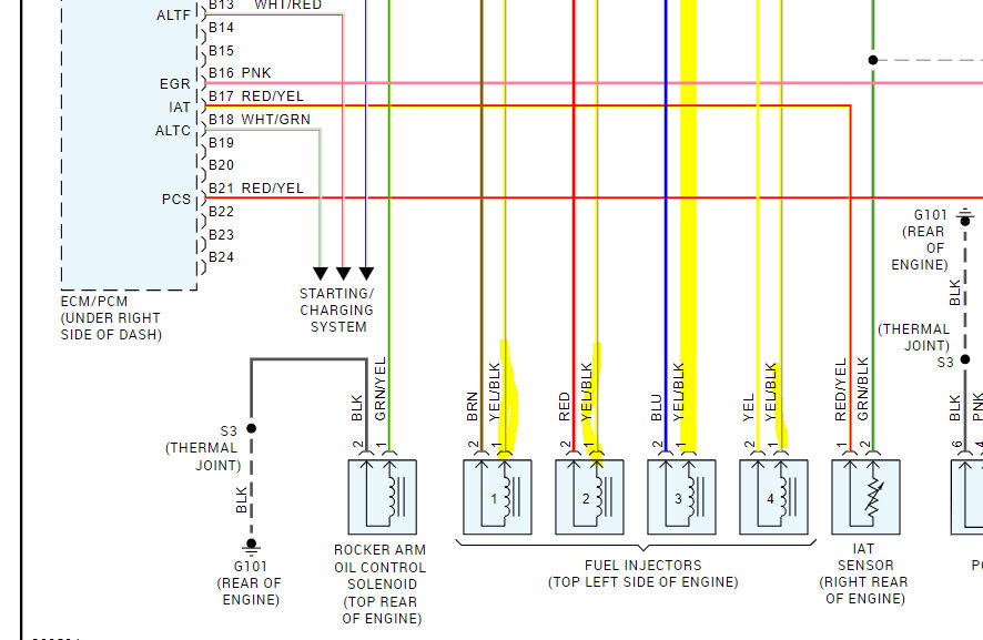

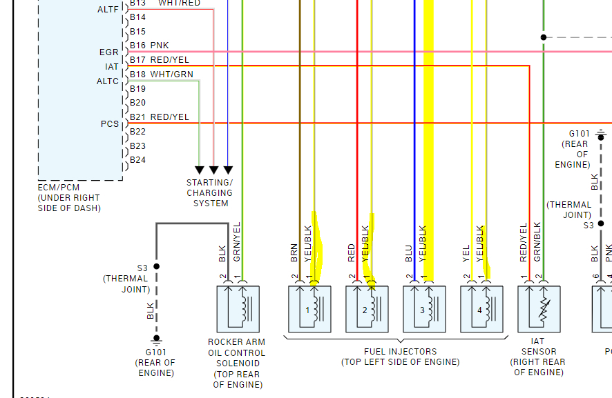

If it has spark, fuel, air, compression, and the timing is correct, it has no choice but to run. You may be getting fuel to the engine, but the injectors may not be working.
At each fuel injector, there will be a yellow wire with a black tracer. That wire should have battery voltage at each injector when the key is in the run position. Check that for me.
See pic below.
