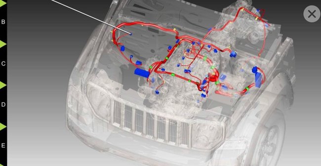

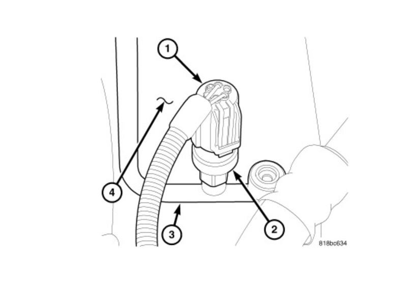

AC kicks off and on. I need the AC low pressure switch location.
Mar 4, 2018 at 1:49 PM
Experienced Mechanic
52,796 POSTS
Good morning.
The switch is on the passenger side back by the firewall in the AC line. Picture attached.
The AC may be cycling from low Freon or expansion valve not holding correct pressure. Have you had the system checked?
