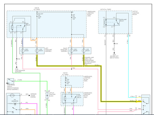

I’m Just trying to put on some aftermarket headlights, and I need to know what are the low beams? There are two dark blue wires connected, so I’m at a lost to know which is which. I saw on another post where they said dark blue was the low beams and the post was for a 2004 Impala.

Yes, the dark blue one is for the low beam headlight.
I have attached the wiring schematics below for your reference.
Let me know of any questions.
