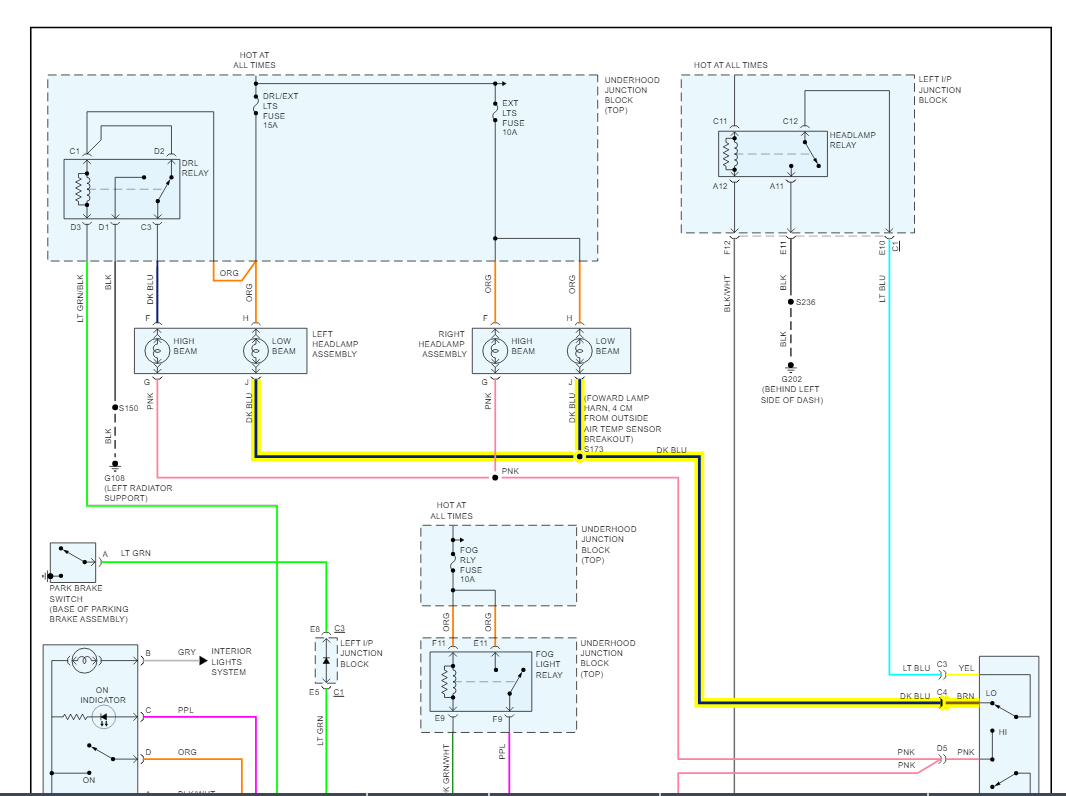

Installing aftermarket headlights and I need to know which wire is for the low beams?
2000 CHEVROLET IMPALA
200,000 MILES • 3.8L • V6 • 2WD • AUTOMATIC
GUTIERREZ JOSHUA
I’m Just trying to put on some aftermarket headlights, and I need to know what are the low beams? There are two dark blue wires connected, so I’m at a lost to know which is which. I saw on another post where they said dark blue was the low beams and the post was for a 2004 Impala.
Jun 23, 2022 at 7:22 AM
SQM
  • 6,383 POSTS
Yes, the dark blue one is for the low beam headlight.
I have attached the wiring schematics below for your reference.
Let me know of any questions.
