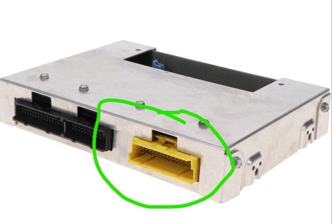

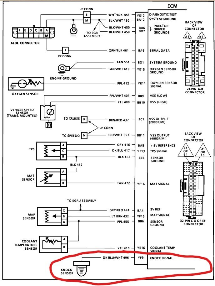

Need to know which wire connector on the ecm controls the knock sensor data.
1989 OLDSMOBILE CIERA
15,500,198 MILES • 2.8L • V6 • 2WD • AUTOMATIC
CUT213
  • 37 POSTS
Code 43 issue. After several months of failing to resolve this issue, recently came across info that resulted in a discovery as to the actual cause of this issue. In need to probe the wires at the ECM connection in order to check for a possible short to power of the actual Knock Sensor wire. It strongly suggest that the knock sensor wire is getting a power spike from another source only while the engine is running. Key off test indicate normal function of the knock sensor functions, but when the engine is actually running the circuit is actually spiking in excess of 6.875 volts. This is the problem for the code 43 light staying on, the ECM relates this to a "DETONATION KNOCK". This means one of two things, A short to power in the wire circuit or faulty mem-cal. So I need to which connector on the ECM module holds the Knock sensor wire. I need to conduct a continuity on this circuit and see if I can determine which other wire might also be connect to this circuit. If I can not find the source of the fault this way then I will cut the knock sensor loose close to the main wire connector and add a new wire directly to the knock sensor and retest the results to see if this removes the power spike to the knock sensor circuit. I need to know which connector and which pin and the wire color on that connector. Thanks!

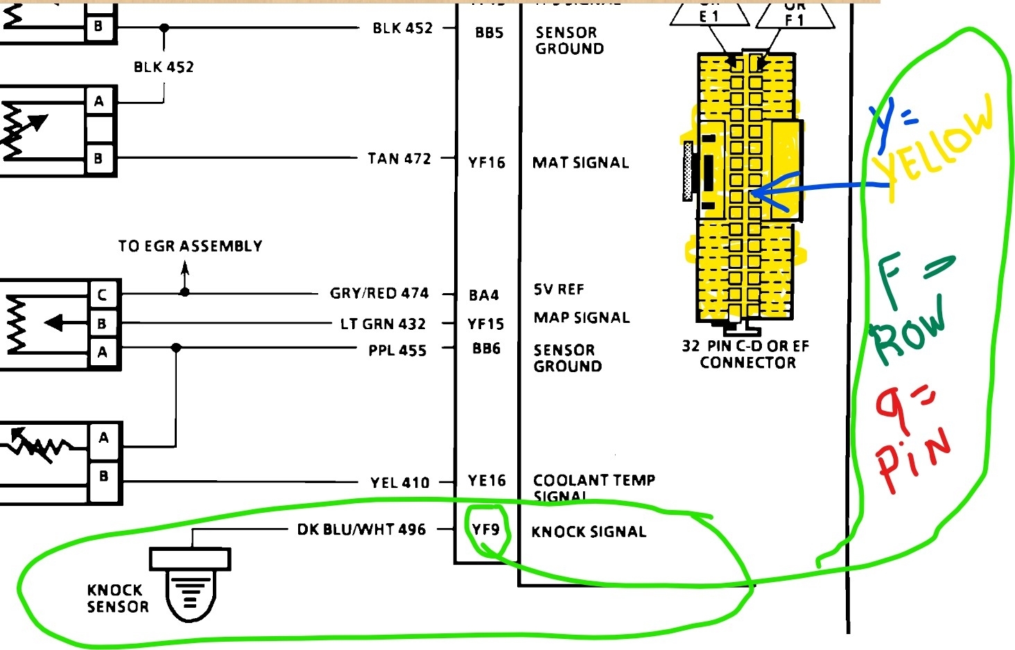

On an 89 I'd suspect the ECM over a short but Here is the connector info. You are looking for a Dark Blue wire w white trace on terminal 9, row F, in the yellow 32 pin connector. Unplug it, de-pin the connection and plug it back in. Start the car, any voltage on the wire with it disconnected? Yes, run an overlay. No - check the ECM pin, does it show high voltage? Yes - bad ECU.

OHHhhh.... by the way , Thanks for the info. That should get me to where I get this issue resolved after two years and almost 6000 miles driving with code 43 light and retarded timing and awful gas mileage. I got to clear the work shop so I can get this car back inside out of the weather, so I can teardown, test the wires and determine what is at fault. Been a looooong battle on this one. Hard to find solid info on the OBD1 vehicles. Thank you so much!!!

Okay.........the car is now completely FIXED!!!! For anybody that wants to track the full repairs just look at this cars history. See all the things that were done and replaced. Most was a waste of time and money. There were actually 3 real issues that were problems.
#1 Stalling out and not restarting quickly and overtime each stall it took longer to recover to start again. Cause: 1 Faulty fuel injector on each side of the engine. #1 & #2 injectors were out of spec on OHM's. This caused the ECM to become confused and shut off the injectors all together. Once the injectors were replaced the stalling out stopped completely and the car was drivable and reliable. It never stalled again.
#2 Engine running rough and stumbling under light engine loads and poor fuel mileage, full throttle was good. Cause: Cracked or broken plastic vacuum tubes on the engine. The fuel pressure regulator on the 2.8 Multi port FI is controlled by vacuum. Loss of vacuum would not let the regulator open as fuel demand lightly increased, full throttle quickly over came the problem but only under 3/4 throttle or more, once you let up to cruise the rough running and stumbling returned. Replaced all the plastic tubes and rubber hoses in the engine compartment. This restore normal running and fuel mileage
#3 The worse problem: Code 43 Knock sensor issue. Code 43 retards engine timing as much as 14 degrees. Massive amount of time and money was wasted here. ACTUAL CAUSE: Faulty memcal or prom chip. Chip was corrupt and sending false voltage spikes that the ECM thought were " Detonation Knocks" even at idle, which can not happen. I tracked it down the the memcal chip. Once the chip was replaced the timing was restored and the engine returned to completely normal function. If you have any of these issues you might want to track this cars history to see the long drawn out repair attempts. Make sure the replacement memcal chip has the same code as the one in your car or it may not work correctly and might damage other components.
