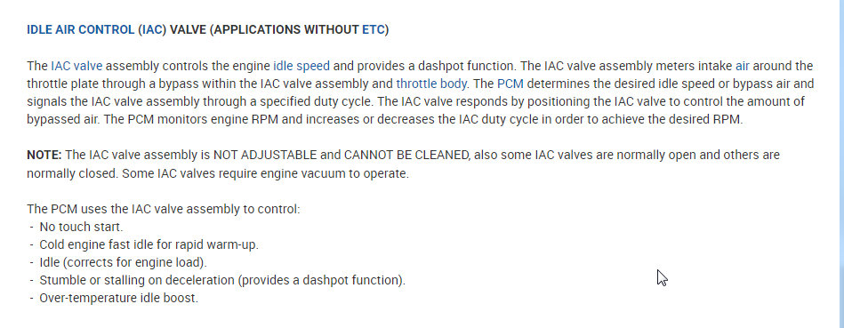

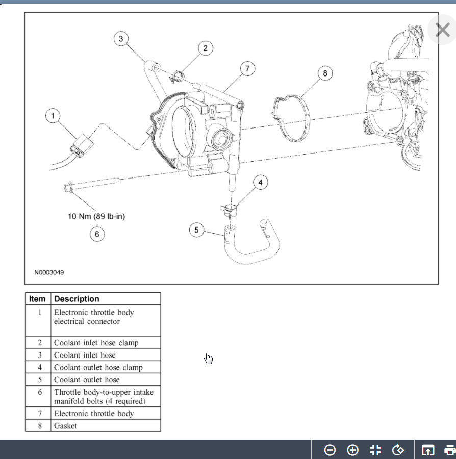

Where is the bwd fuel injection idle air control valve located on this engine? is there a video that can show me where it is and how to change?
Mar 10, 2021 at 8:41 PM
Just to clarify what you are looking for, it is the idle air control? I am just not sure what you mean by "BWD fuel injection" part of this.

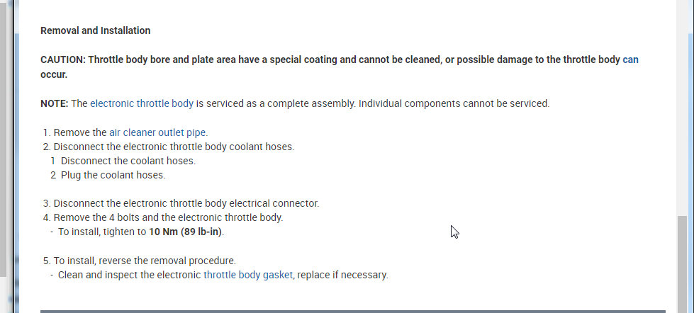

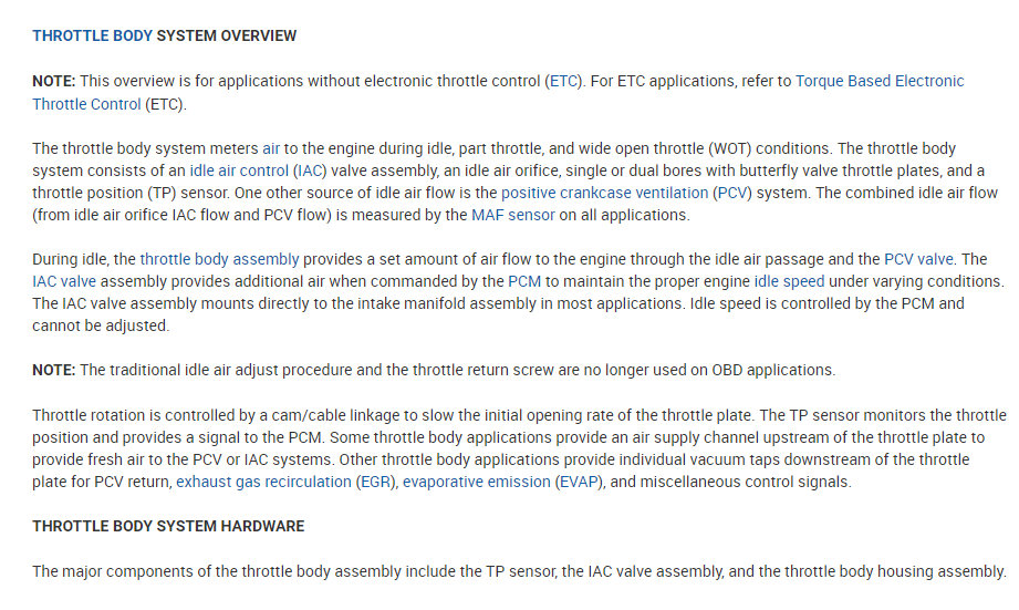

This idle air control on this vehicle is part of the throttle body. I attached the detail below about this. However, do you have a code or some other reason for needing to replace this? If so, what is the code?
Let's run through this material below and let me know if I am misunderstanding. Thanks
