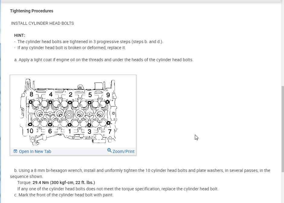

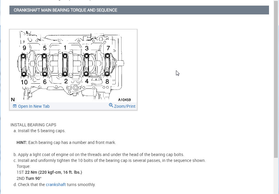

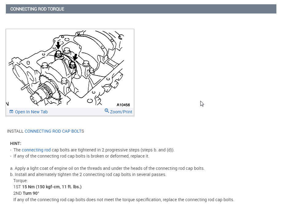

Need to know torque settings for main bearings, big ends bearing and cylinder head bolts
2002 TOYOTA PLATZ
300,000 MILES • 0.9L • 4 CYL • 2WD • AUTOMATIC
PETER MTEYA
What is are the torque specs for main bearings, big ends bearing and cylinder head bolts.Thank you in advance for those who will help.

Can you help me a little bit with the engine that you have? It says 0.9L but I don't show that as an option. Have a 1.0L, 1.3L, 1.5L or 1.6L.

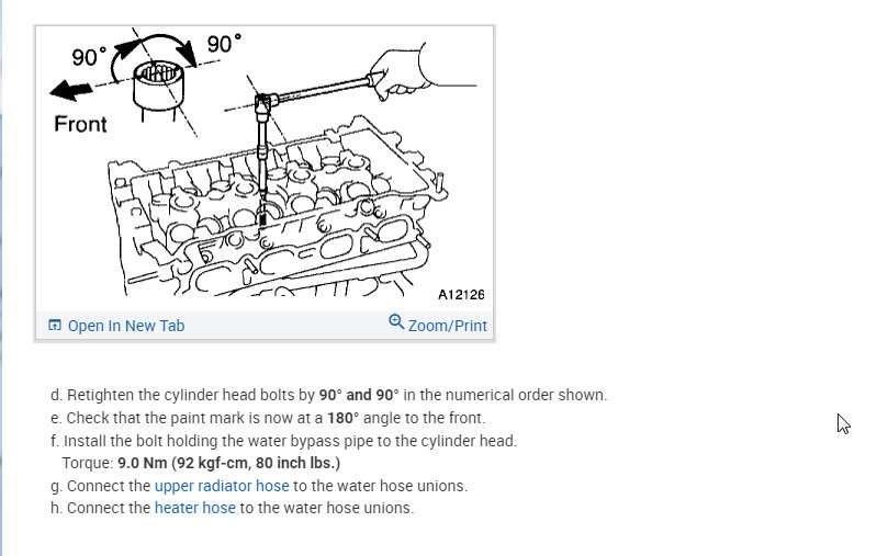

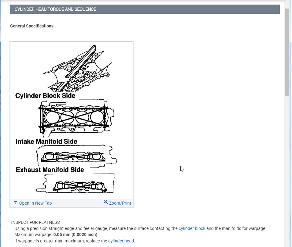

I have attached the process we have for these engines. I am not positive if there is another engine but if there is, I am sure the process is the same.
Let us know if you need more info. Thanks
