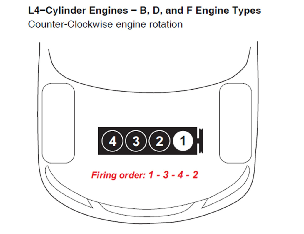

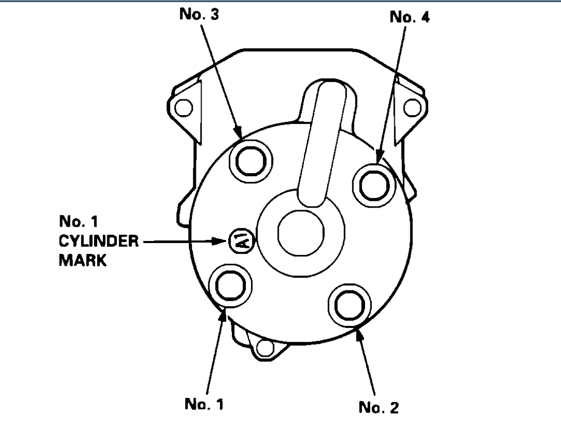

I need to know the firing order.
Aug 1, 2021 at 5:29 AM
Good afternoon,
I attached the firing order for you to review. I attached both the cylinder location and the wire in the distributor cap location as well. Check out the diagrams (below). Please let us know if you need anything else to get the problem fixed.
