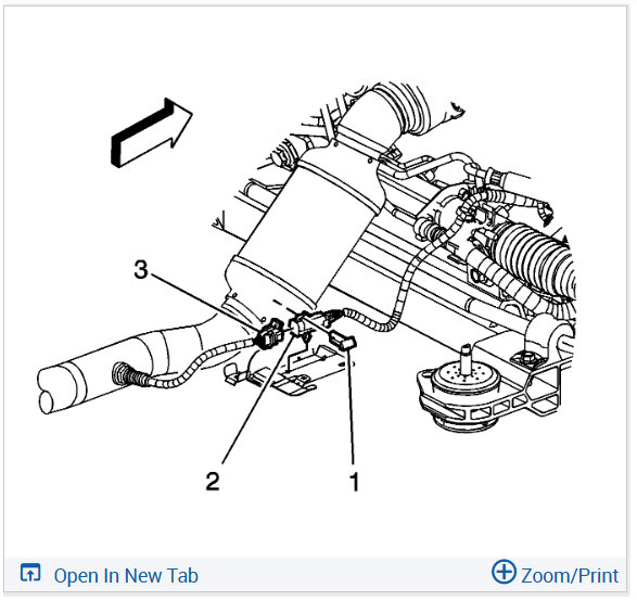

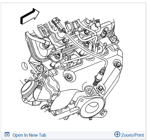

Need to know the locations of all three O2 sensors in my car listed above and need a diagram showing locations on engine. please and thank you.

Bank 1 sensor 1..the rear exhaust manifold before the cat
And bank2 the front exhaust manifold sensor 2 before the cat
And the third ones after the cat usually where the exhaust exits the cat ..look for the wires leading to them from the plug which is usually about 12 inches away from the sensor. Hope this helps.

Do you have a repair diagram i can show my mechanic. He couldn't find 3 sensors. He installed 2 he could find. My car js still choking out/and hesitating and speedometer still jumping. So that he can get the third one installed. Thank you and I appreciate you.

He changed (2) O2 sensors. So maybe the 3th sensor he can't find is the one that is needed.so I'm assuming you could not provide me a diagram in this site.

So there are three oxygen sensors, two are in the exhaust manifolds bank 1 is on the right side of the engine. The third or secondary sensor is in the exhaust pipe after the catalytic converter. Check out the images (below). Let us know if you need anything else.
