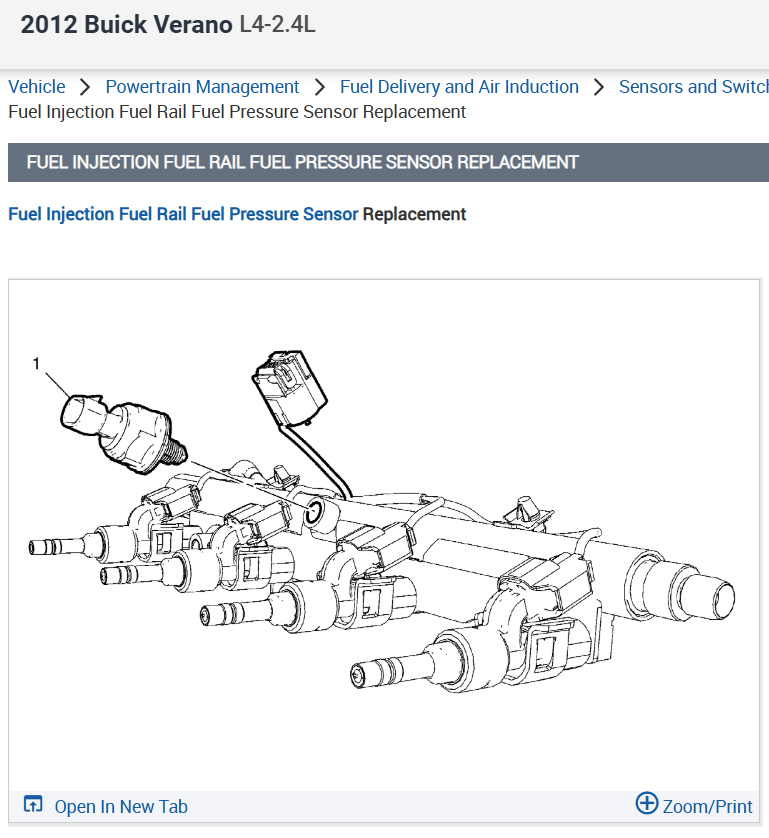

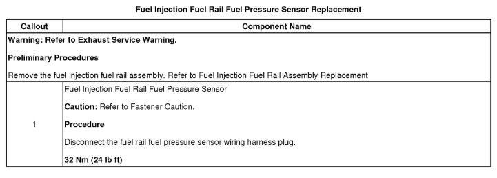

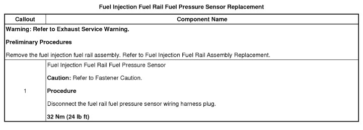

This is a super common repair; you need to replace the fuel pressure sensor. There is a chance the high- or low-pressure fuel pump is having an issue, but this is the first step.
P0191 - Fuel Rail Pressure Sensor "A" Circuit Range/Performance
Check out the images (below). Let us know how it goes.
