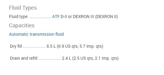

i need to know how much and what brand or type of transmission fluid i need in my 2002 Toyota Tacoma. going to be changing transmission filter soon would like advice.
Jun 3, 2019 at 7:56 AM
Good afternoon,
Attached is the fluid amounts for your transmission.
