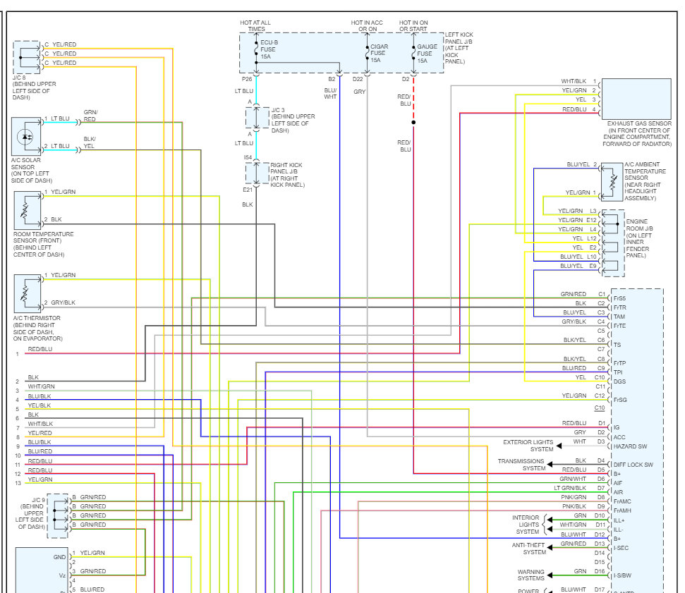

Trying to repair this, as the only issue is that the A/C On/Off switch doesn't work when plugged in. I just need to know which pins control this functionality so I can attempt to trace back the malfunctioning component.
Part number of the unit in question: 88650-60212
I wouldn't normally bother, but this unit is quite valuable.

It might be the controller itself, but I would run a CAN scan to see what's going on. You can get a CAN scanner (Controller Area Network) from Amazon.
https://youtu.be/u-4syLc-ifQ
and
Here is a list of CAN scanners starting at about $25.00 on Amazon:
https://amzn.to/3DBMlc7

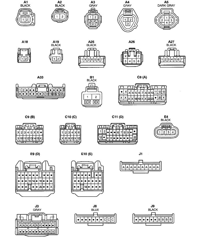

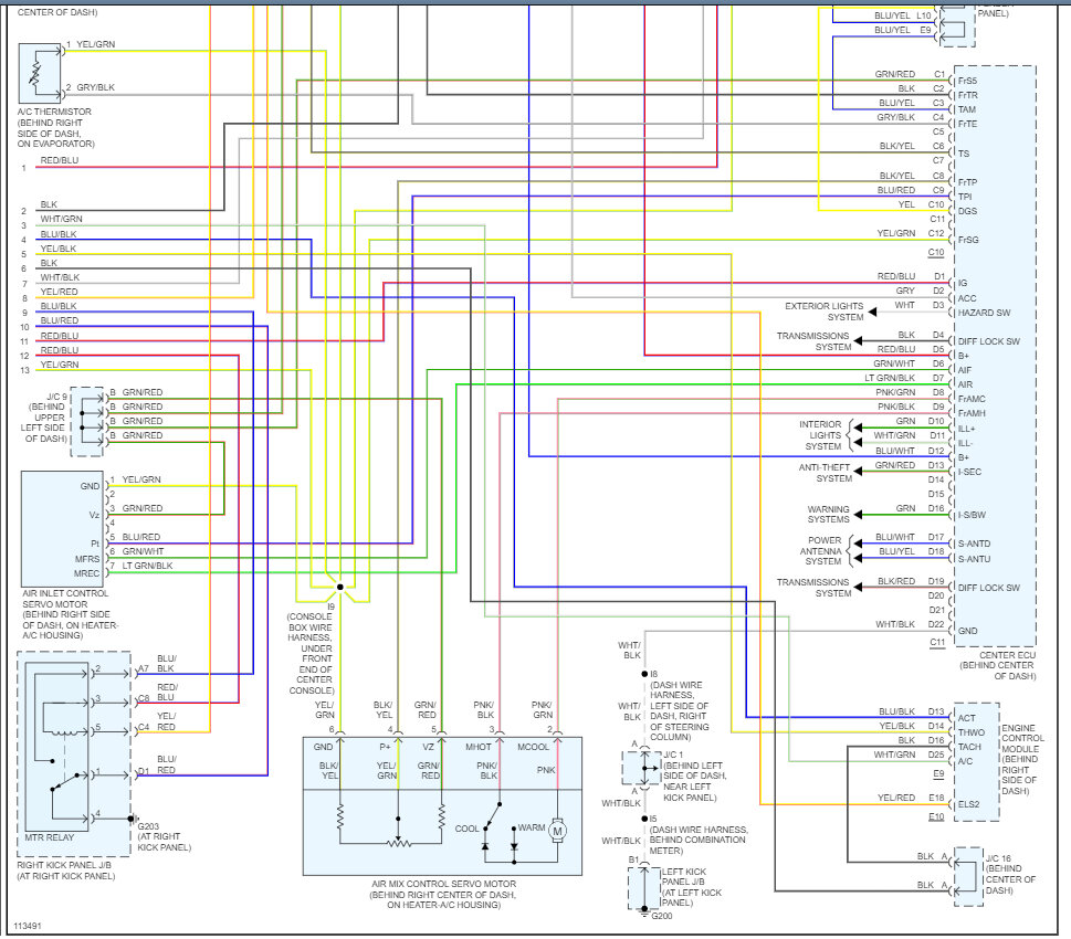

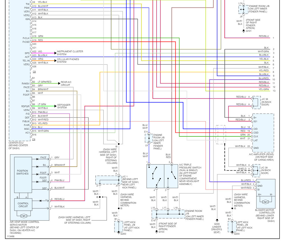

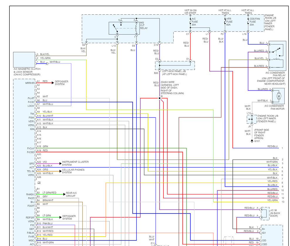

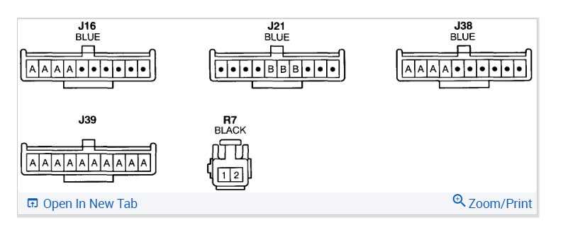

Here are the A/C wiring diagrams and the pin outs in the images below, please let me know what you find.
