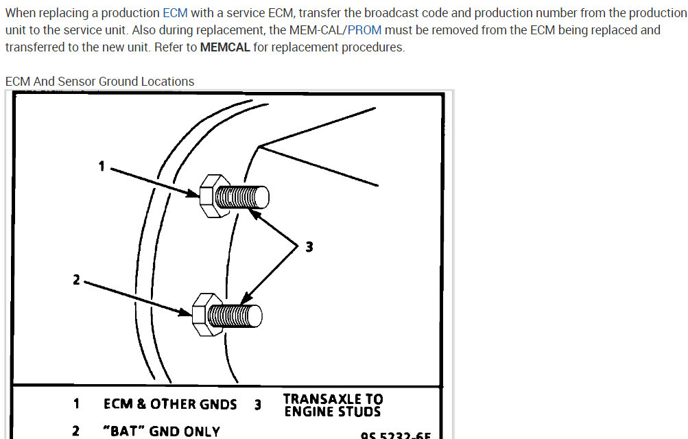

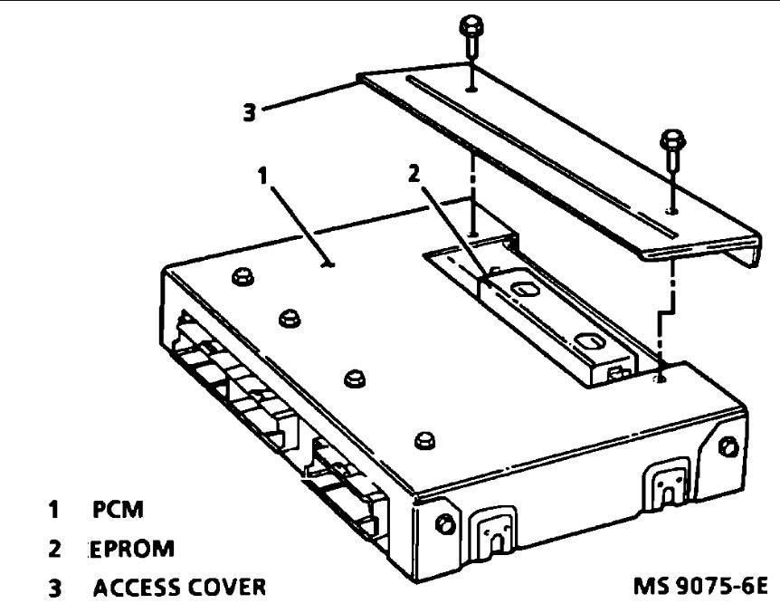

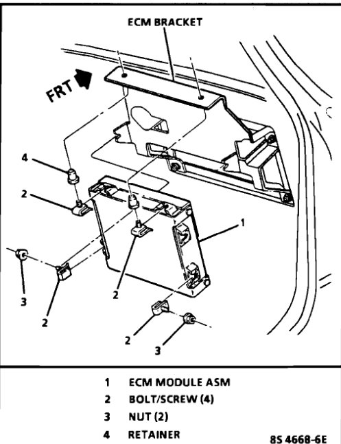

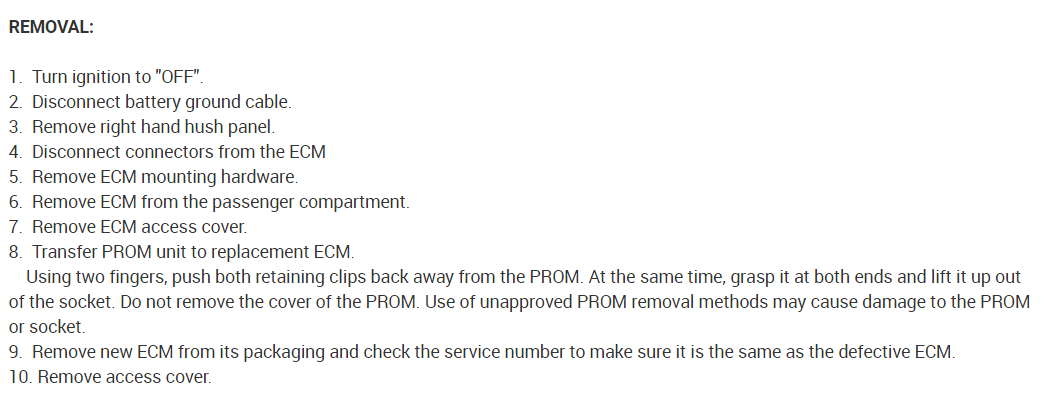

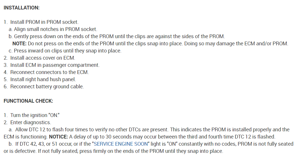

Car listed above 3300. Computer is bad (among other things) and needs replacing. Cannot find a diagram of its location online. Suspect it is behind glove box inside vehicle, but would love to know for sure before i start taking stuff apart unnecessarily. Can anyone offer an exact placement so i can access and switch the unit? Thanks in advance.
Mar 10, 2019 at 7:55 AM
DANNY L
  • 5,648 POSTS
Hello, I'm Danny.
Here is the information you've requested. I've attached picture steps below showing how to replace the PCM on your car. Hope this helps and thanks for using 2CarPros.
