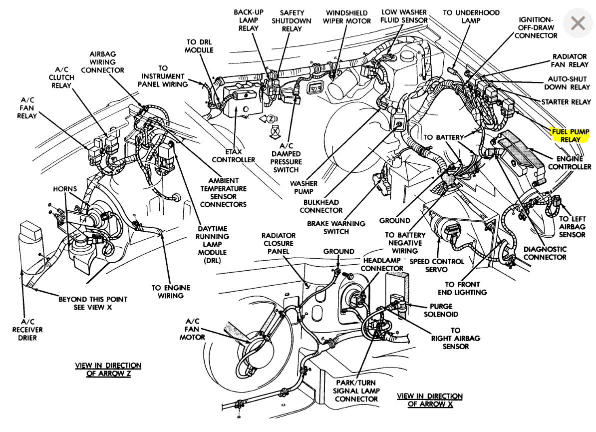

Where is the fuel pump relay located?
70,000 MILES • 3.0L • V6 • 2WD • AUTOMATIC
RONALD STORLIE

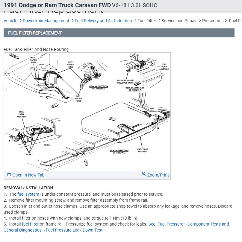

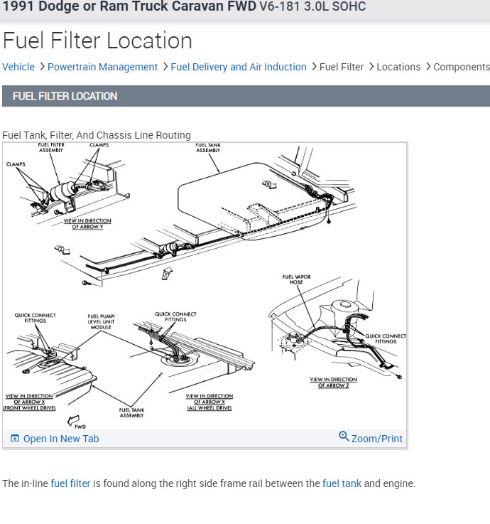

I need to change fuel filter.

The fuel pump relay is located on the rear right hand side of the engine compartment, if you are facing the engine (see diagram below)
The in-line fuel filter is found along the right-side frame rail between the fuel tank and engine.
https://www.2carpros.com/articles/how-to-change-a-fuel-filter
