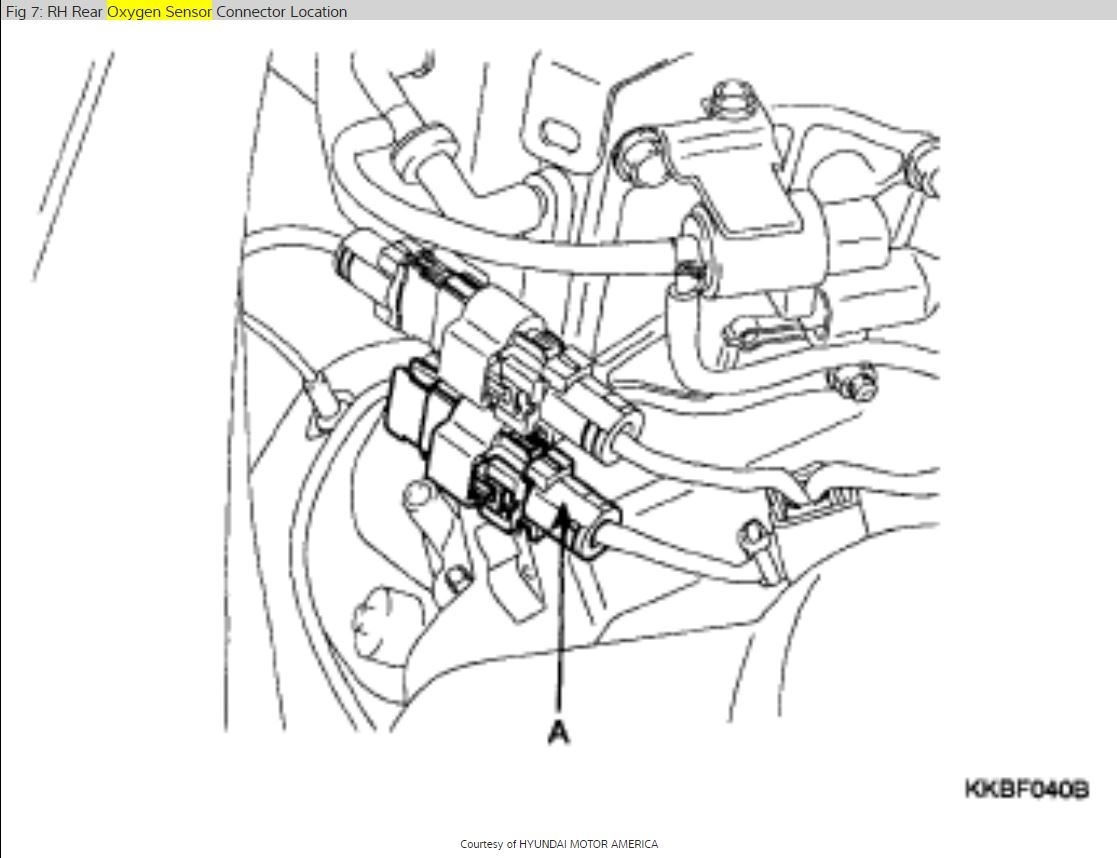

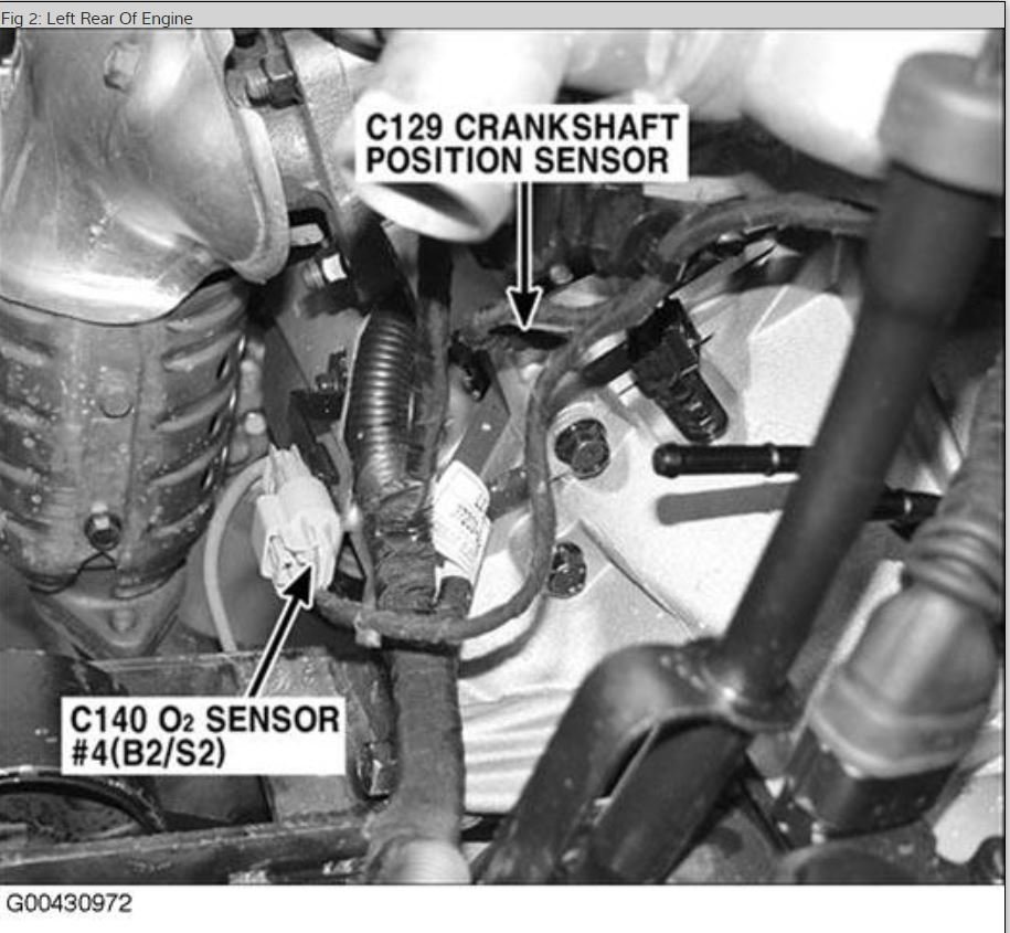

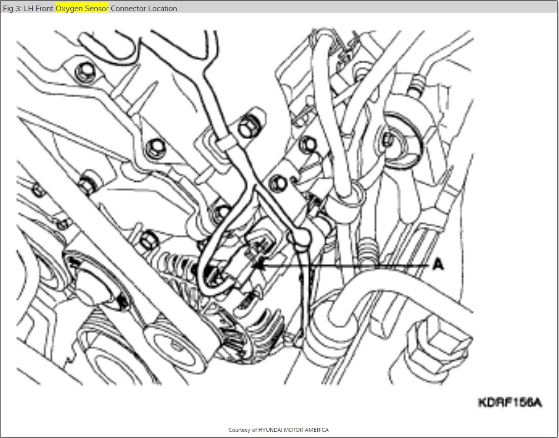

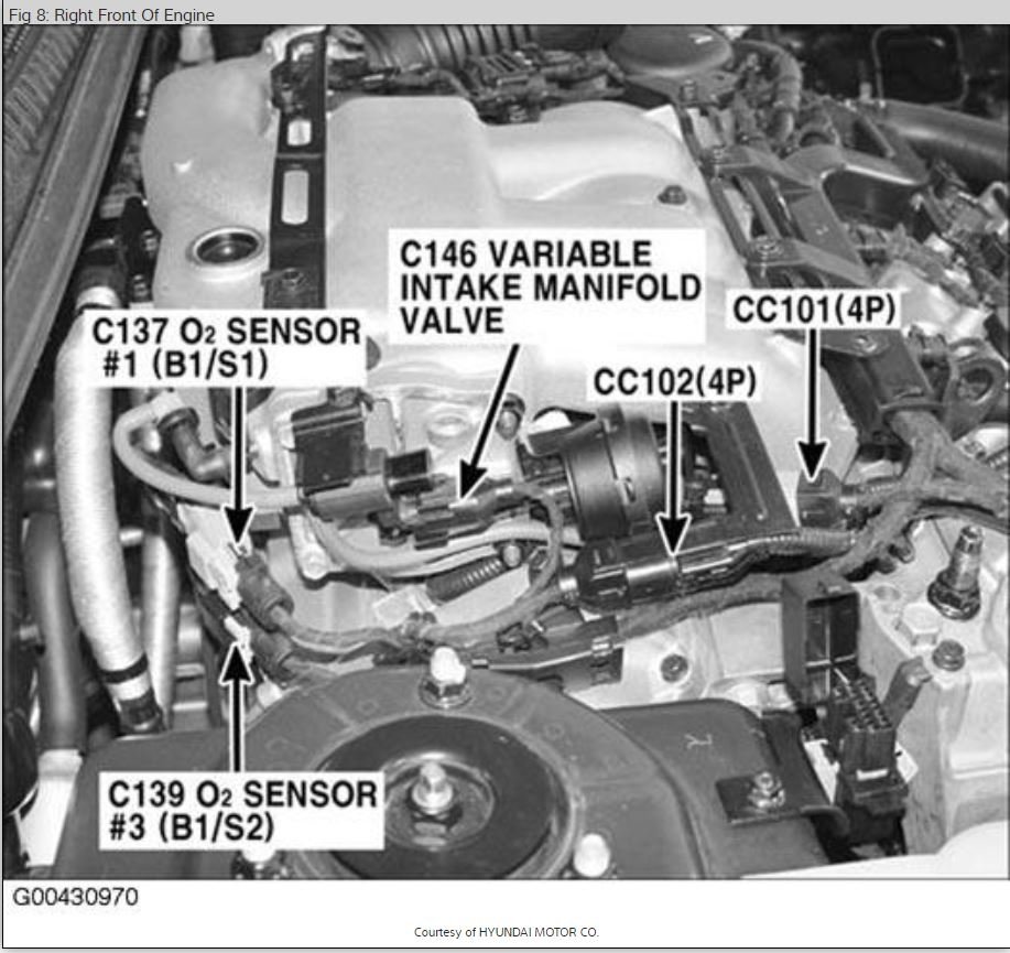

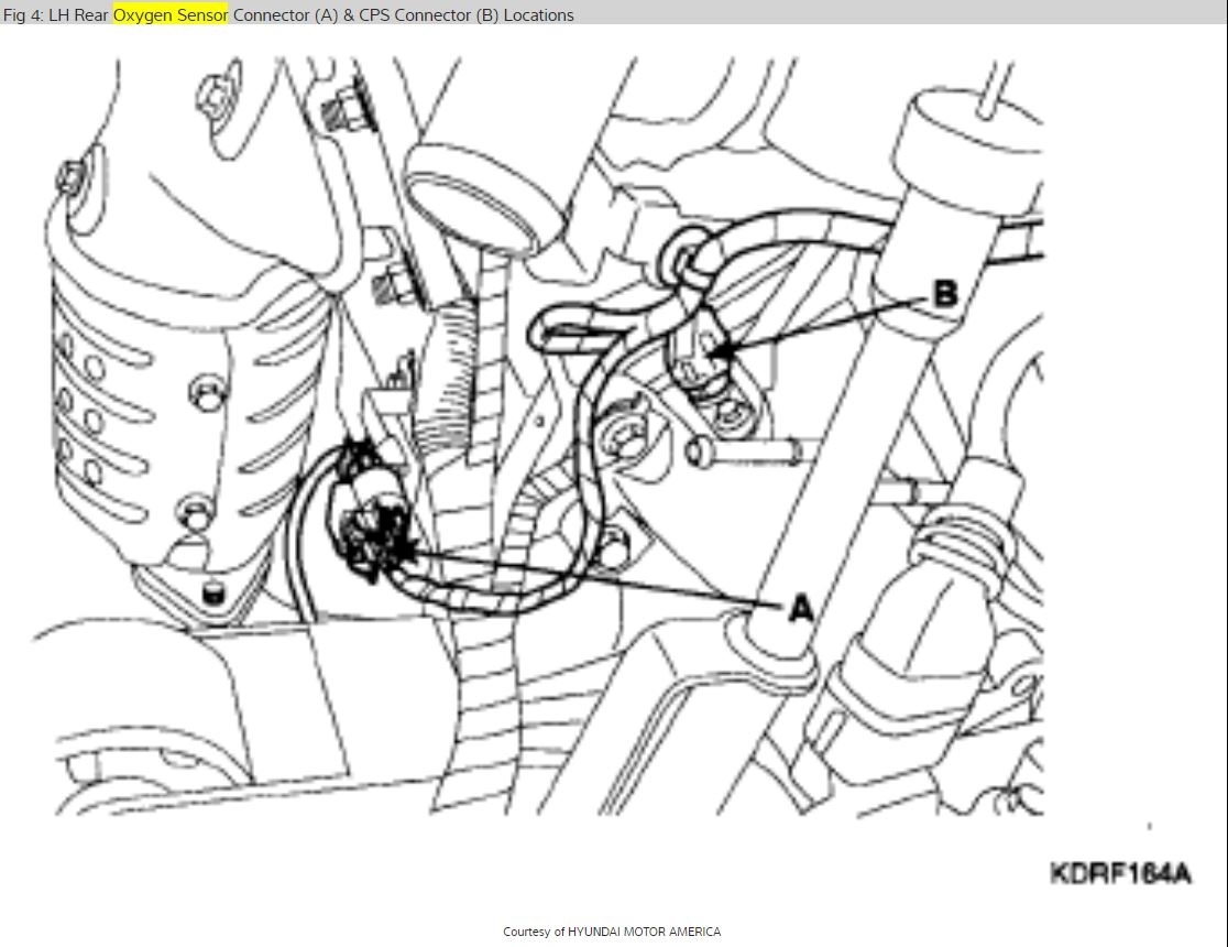

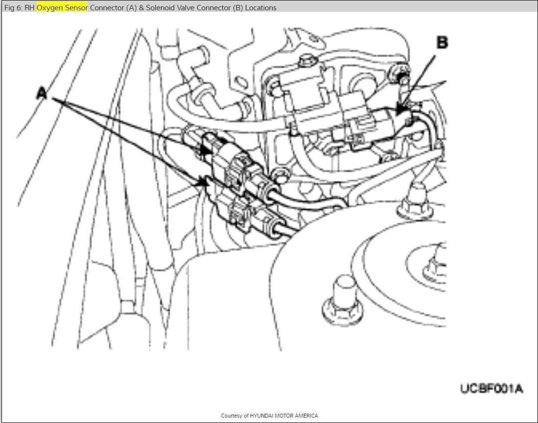

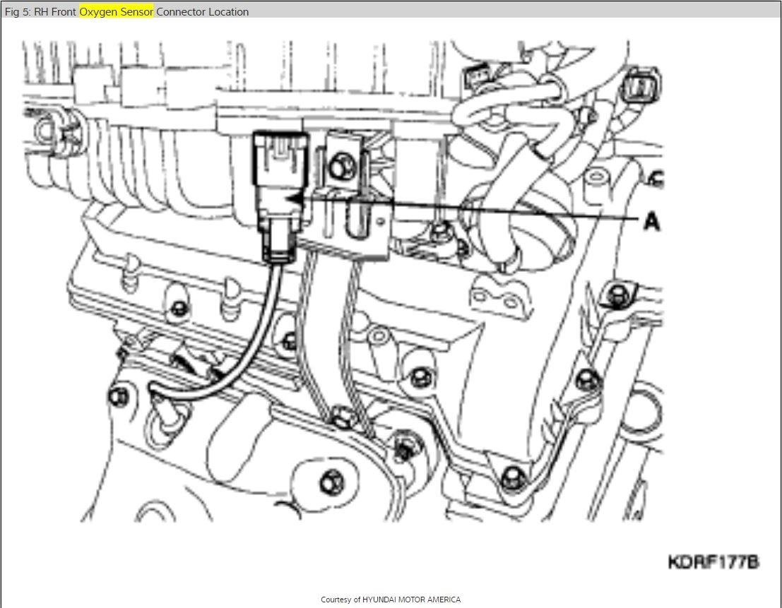

need to find location of oxygen sensor
2007 HYUNDAI AZERA
160,000 MILES • 6 CYL • 4WD • AUTOMATIC
SYFLORES
need to replace the sensors how do I replace?
Apr 20, 2018 at 1:13 AM
HARRY P
  • 2,292 POSTS
The oxygen sensors are all on the exhaust system. There should be one on each side of the engine (front and rear, that is) and one more downstream sensor just a little past the catalytic converter, but before the muffler. Changing them is simple, really. You will need either a 7/8' wrench or a ratchet with a oxygen sensor socket (also 7/8'). Just take one out and put the new one in.
Apr 20, 2018 at 3:43 AM
PATENTED_REPAIR_PRO
  • 1,853 POSTS
These diagrams may help.
