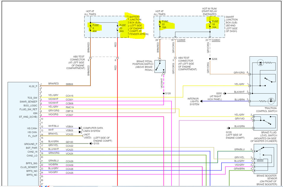

Where is the ABS fuse located?
2006 FORD EXPLORER
200,000 MILES • 4.6L • V8 • 2WD • AUTOMATIC
EJAMAL95
My car sometimes won’t drive at all and other just hear a noise took it to a shop they didn’t do ABS work but said that’s the problem and the brakes and engaging themselves.

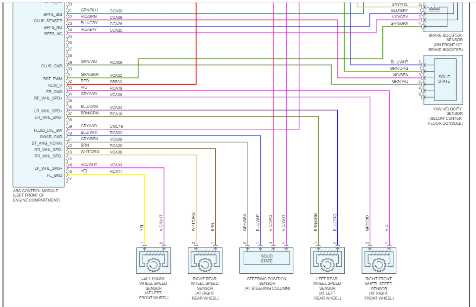

When you hear the noise, does the brake pedal seem much stiffer or do you feel any vibration through the pedal?
I ask because I'm not sure how the ABS would turn itself on. If it is actuating, something such as a wheel speed sensor is failing and causing it.
I attached the wiring schematic below for the ABS/Traction control so that you have a reference. I highlighted 4 fuses that are related to the ABS control module.
Let me know if that helps or if you have questions.
take care,
joe
See pics below. Note: I had to cut the schematic in two to make it readable for you. I did overlap the two so you can follow from one to the next.
