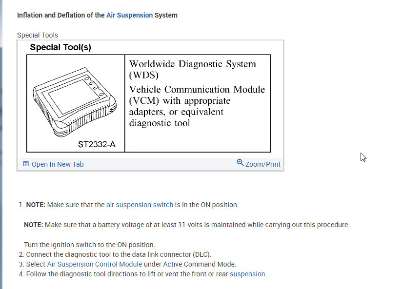

If you have a scan tool you can deflate the system. I attached the process.

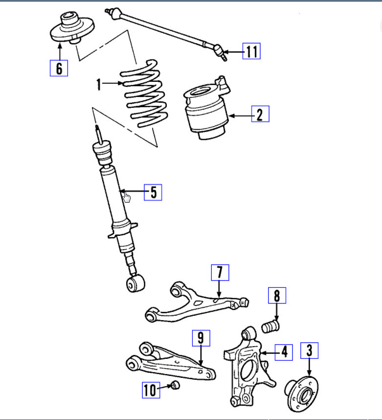

If not then look at number two you will see the air spring. It will have an air line going to it. I would just support frame of the vehicle with a jack and remove the air line. Clearly you will get a burst of air but if the vehicle is supported with a jack, it won't drop when you remove it. Just make sure you turn the air suspension switch off so that the compressor doesn't run to try and fill the system.

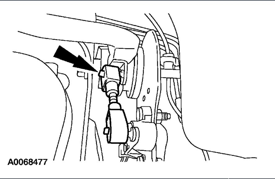

Okay, disconnect the height rod at the rear and move it up and down and see if it opens the solenoids.
Be careful if you are under it.
I attached a picture of it for you.

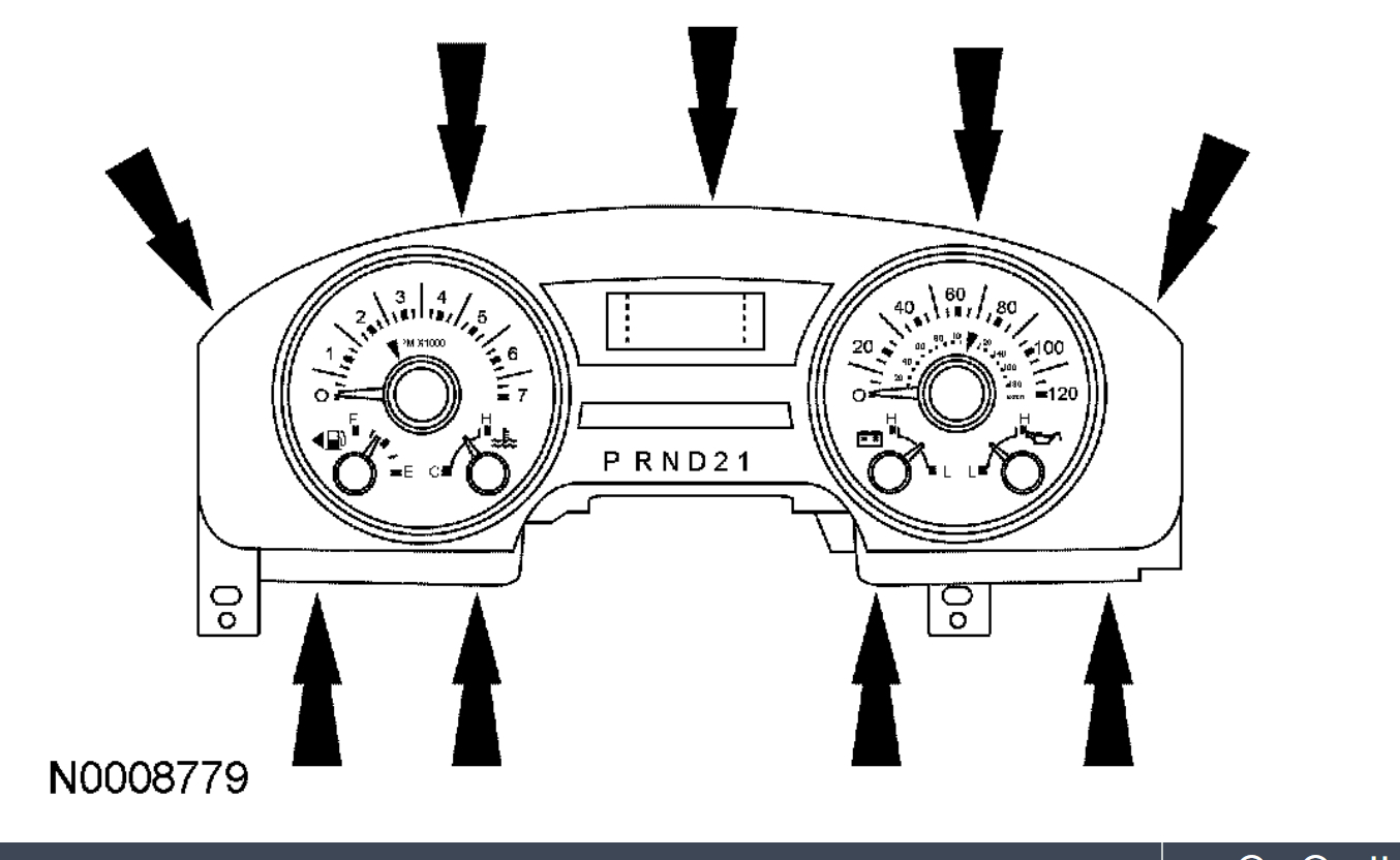

Now I have to figure out how to remove "Check Air Suspension Light" on Dash..
Any Suggestions?.
Nov 24, 2020 at 8:15 PM

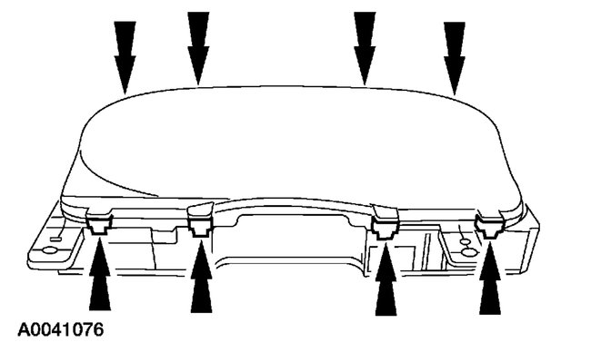

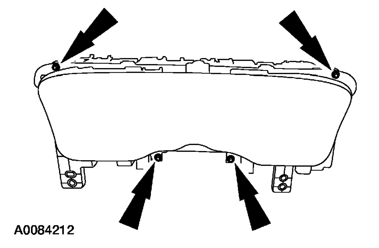

This will not be easy as the system is always set to default and the light will come on. Disconnecting fuses will not do it as other systems are tied into the fuses as well.
The only way to do it is to remove the cluster and remove the bulb. There will always be codes set for the suspension.
I attached the procedure and some pictures for you.
INSTRUMENT CLUSTER
Removal and Installation
All vehicles
CAUTION: Electronic modules are sensitive to electrical charges. If exposed to these charges, damage may result.
1. NOTE: Prior to removal of the instrument cluster, it is necessary to upload the instrument cluster configuration information to the diagnostic tool.
Depower the supplemental restraint system.
2. Remove the instrument panel finish panel.
Expedition
3. Remove the screws and pull the instrument cluster out from the instrument panel.
4. Remove the instrument cluster.
Press the retaining tabs, remove the transmission range selector, and position aside.
Disconnect the electrical connectors.
Navigator
5. Remove the 4 screws and pull the instrument cluster out from the instrument panel.
6. Disconnect the electrical connectors and remove the instrument cluster.
All vehicles
7. To install, reverse the removal procedure.
