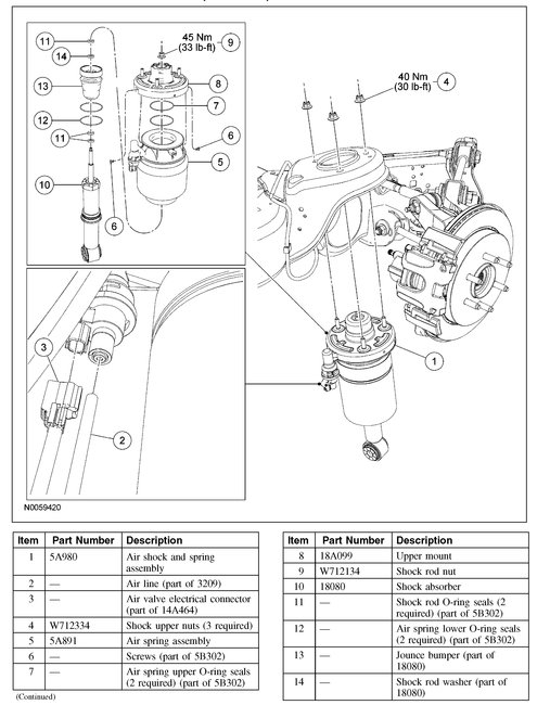

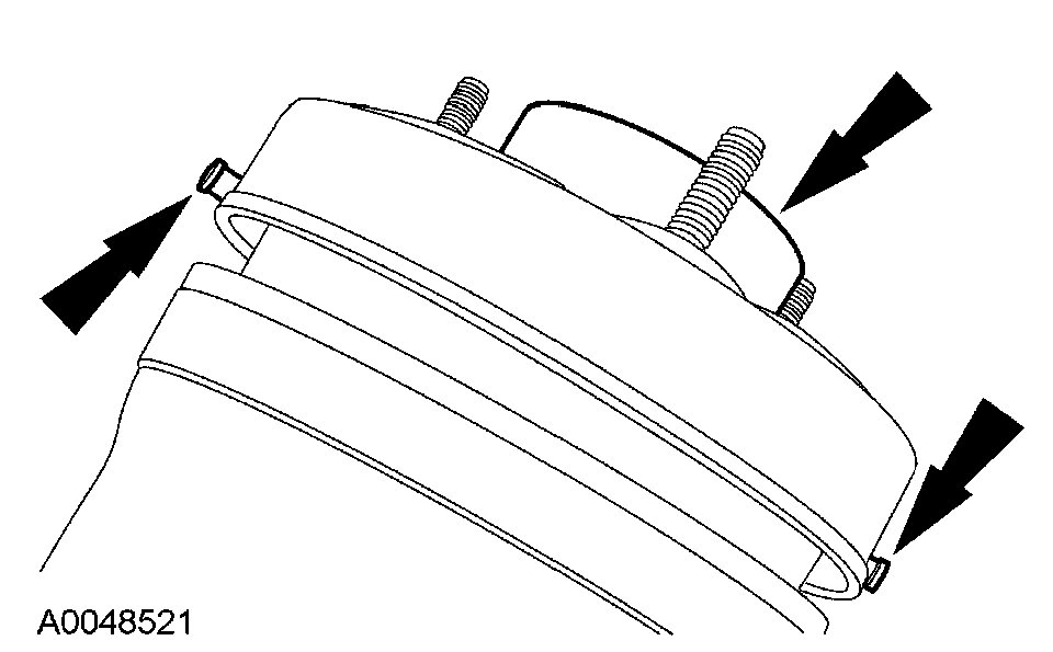

I have the vehicle listed above EL model and the rear air shocks went out. I want to change them out with some new ones I purchased and was wondering what needs to be done and if there is a way to find a diagram on how to change them?

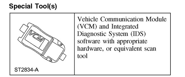

This isn't too hard to do, but it does require a scan tool that can vent the shocks on it.
Here are the directions. The attached pics correlate with the directions.

Special Tool(s)
pic 1
Material
pic 2
pic 3

1. Using the scan tool, vent the appropriate air spring.
2. With the vehicle in NEUTRAL, position it on a hoist.
3. Remove the lower arm.
4. Disconnect the air spring solenoid valve electrical connector.
5. Disconnect the air line at the air valve.
^ Compress the orange quick connect lock ring, then pull downward on the air supply line.
6. Remove and discard the 3 shock upper nuts.
^ To install, tighten to 40 Nm (30 lb-ft).
7. Remove the air shock absorber.
8. NOTE: If the individual spring and/or shock components are not being serviced, continue with Step 14.
NOTE: Use the hex holding feature to prevent the shock rod from turning while removing the nut.
Remove and discard the shock rod nut.
^ To install, tighten to 45 Nm (33 lb-ft).

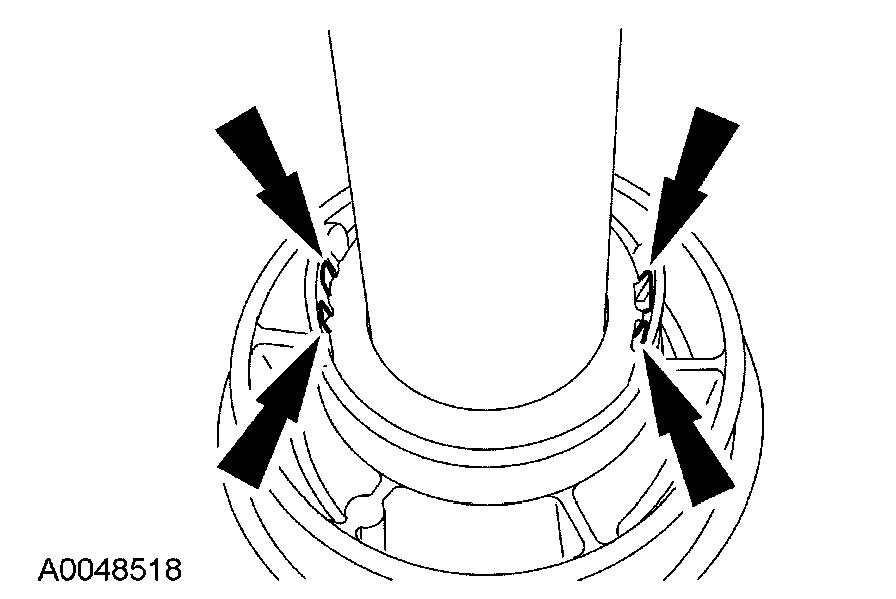

9. CAUTION: If the retainer tabs are broken, a new air spring must be installed.
NOTE: Index-mark the air spring and shock absorber for reference during the installation procedure.
Depress the retainer tabs and remove the air spring.
pic 4
10. Remove the shock rod O-ring seal, washer and jounce bumper.
^ Discard the seal and washer.
11. Remove and discard the 2 air spring lower O-ring seals.
12. Remove the 2 retainer screws and the upper mount.
^ Discard the screws.
pic 5
13. Remove and discard the 2 air spring upper O-ring seals.

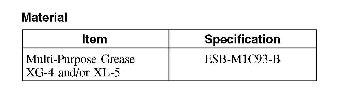

14. CAUTION: Use a suitable press to install the upper mount retainer pins. Do not use a hammer or damage may occur.
NOTE: Make sure that all seals are clean and free of debris.
NOTE: Apply a thin coat of grease to the new O-ring seals.
To install, reverse the removal procedure.
