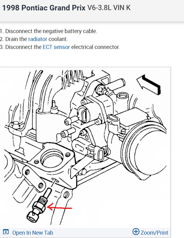

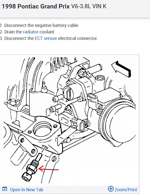

Need to change radiator cooling sensor, where is it located?
1998 PONTIAC GRAND PRIX
85,000 MILES • 3.8L • 6 CYL • 2WD • AUTOMATIC
SUZY MOONEY
My fans work if it is wired to run all the time if it's not it overheats was told fan sensor needs changed. Where is it located so I can change It I'm just getting over having cancer and haven't worked since 2017 so I can't afford take it to a mechanic my ex also stole my car drove it hot now it's missing on 2 cylinders on back of motor. Are the heads cracked?
Oct 30, 2024 at 1:55 PM
  • 54,837 POSTS
I am sorry to hear about your troubles, it sounds like the engine may have had a problem, but it will need to be tested to confirm the problem. Here is a guide to go over that will give you more information. Also, I have included the coolant sensor location so you can swap it out.
https://www.2carpros.com/articles/symptoms-of-an-overheating-engine
Check out the images (below). Let us know how it goes.
