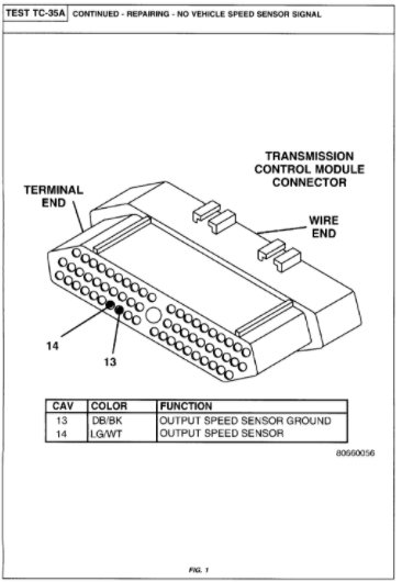

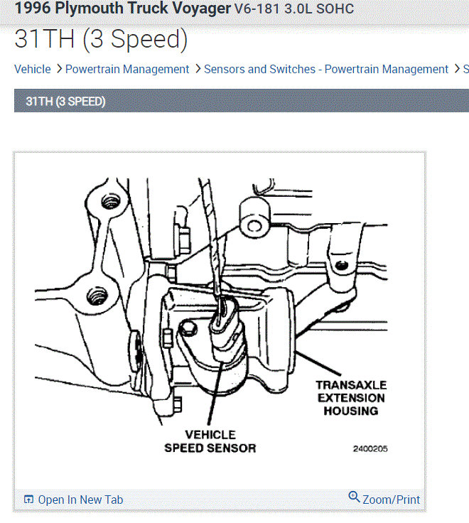

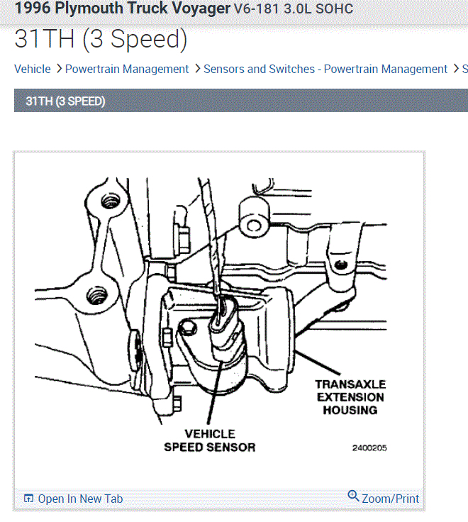

not sure if it's input or output speed sensors. I don't know where to find the speed sensors input or output location or how to replace them.

How do i find and replace the part? i have a new MAP sensor and a vehicle speed sensor already, just need to know how to do the work myself. please can't afford to pay someone else to do it.
Mar 7, 2021 at 12:17 PM
  • 110,240 POSTS

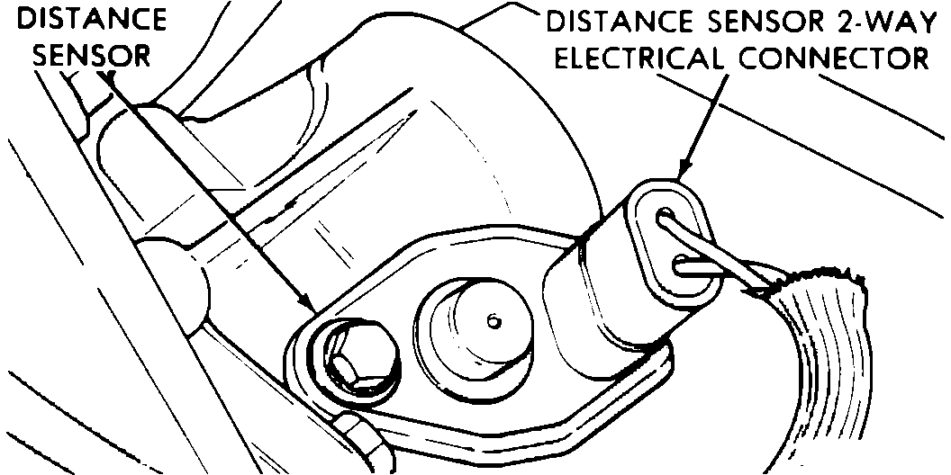

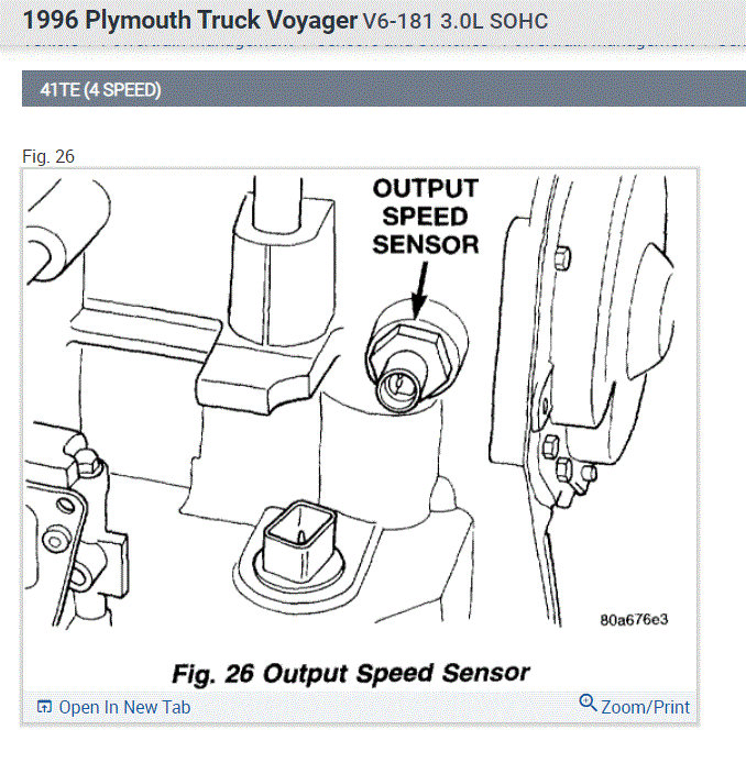

There were two different transmissions used. One was a 3-speed and the other a 4 speed. Pics 1 shows the 3 speed and pic 2 shows the 4-speed sensor location.
As far as replacement, I will provide the directions. The directions are the same. It's the location that is different. The remaining pics correlate with the directions.

Vehicle Distance Sensor

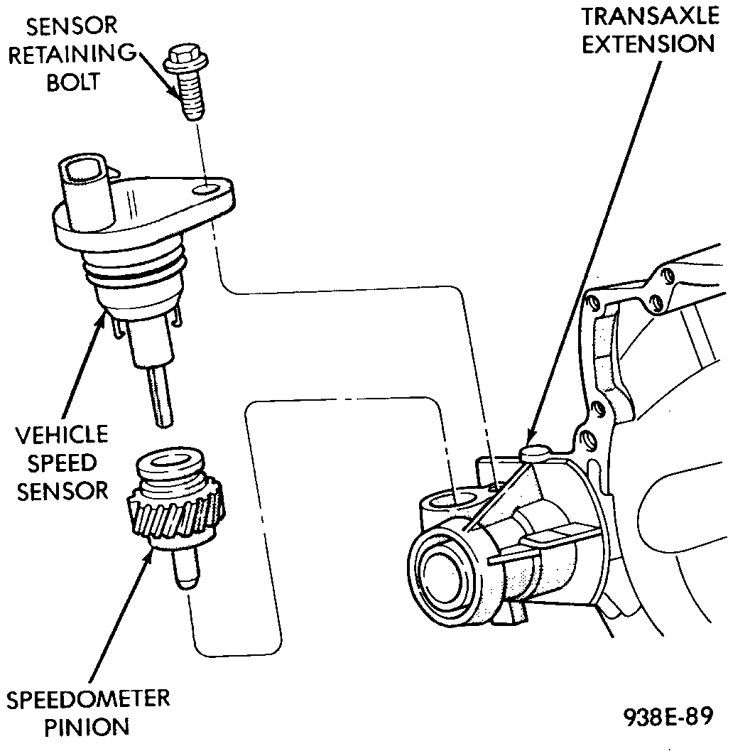

pic 3
Fig. 8 Vehicle Speed Sensor And Speedometer Pinion
pic 4
NOTE: Applies only to vehicles without 4speed/overdrive (41TE) transmission.
Sensor mounted in passenger side transaxle output housing.
1. Disconnect sensor wiring connector.
2. Use a long extension and a 10mm socket to remove hold down bolt.
3. Pull sensor our of output housing -- may have to rotate as you pull.
_____________________________

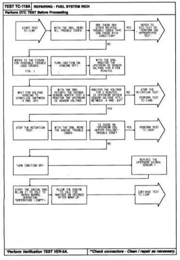

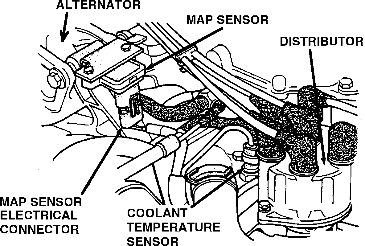

As far as the map sensor, it is located next to the alternator. See pic 5 for location. Here are the directions for replacement.
1996 Plymouth Truck Voyager V6-181 3.0L SOHC
Procedures
Vehicle Powertrain Management Sensors and Switches - Powertrain Management Sensors and Switches - Computers and Control Systems Manifold Pressure/Vacuum Sensor Service and Repair Procedures
PROCEDURES
Map Sensor And Coolant Temperature Sensor Location
see pic 5 again
REMOVAL
1. Remove vacuum hose and mounting screws from manifold absolute pressure (MAP) sensor.
2. Disconnect electrical connector from sensor. Remove sensor.
INSTALLATION
1. Reverse the above procedure for installation.

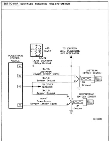

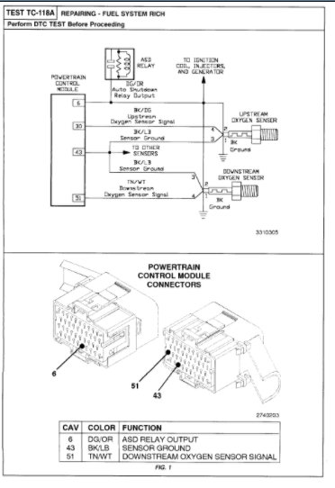

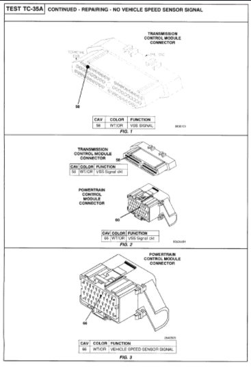

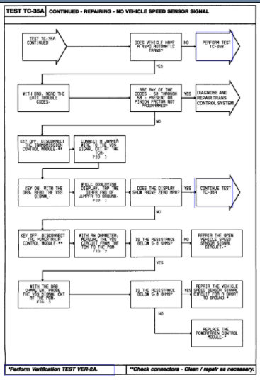

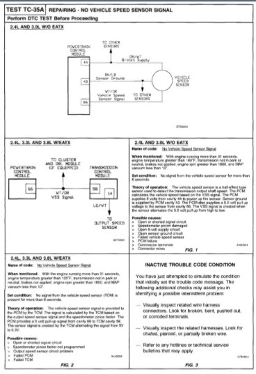

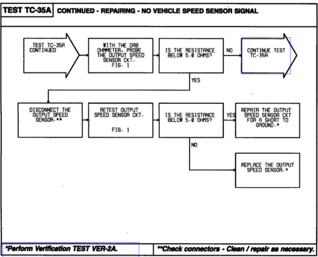

DANNY L
  • 5,648 POSTS
Hello again.

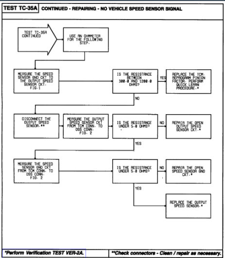

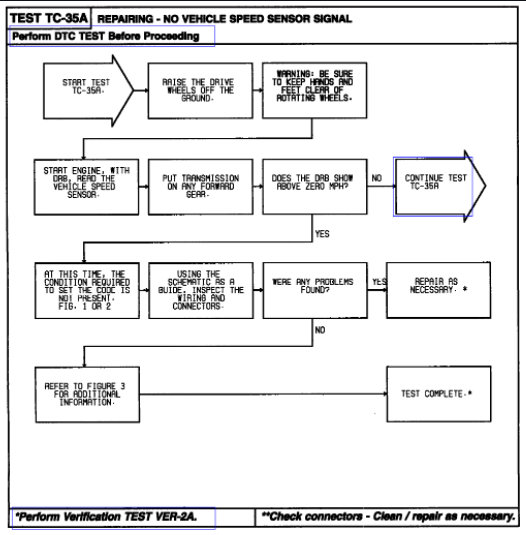

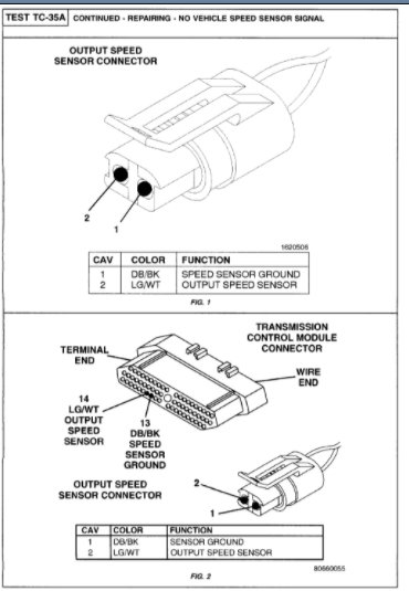

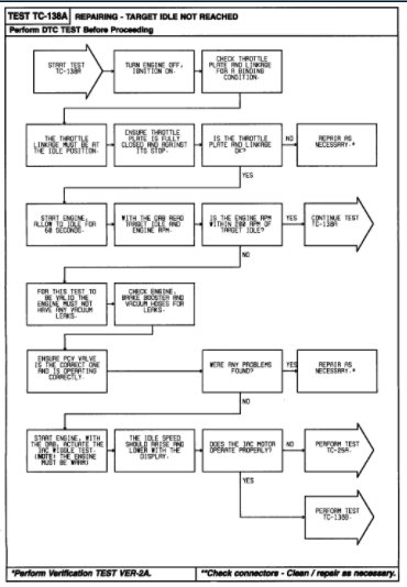

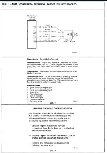

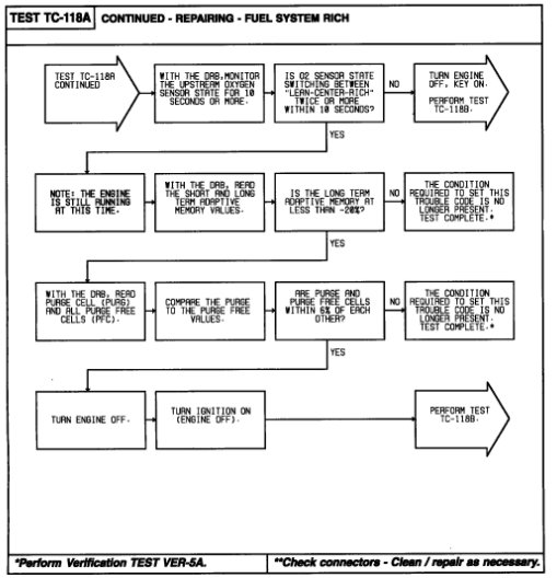

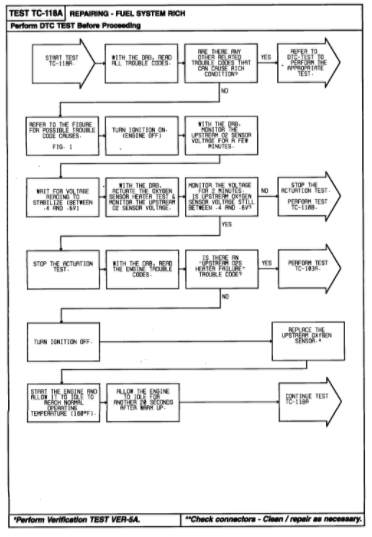

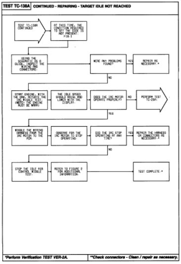

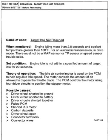

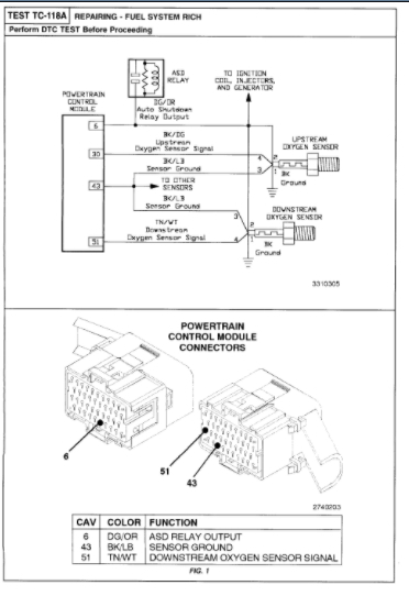

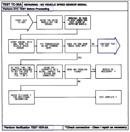

Here is the information for the codes you included in your response. Code P0172 is for Fuel System Rich. Code P0500 is for No vehicle Speed Sensor Signal. Code P1294 is for Target Idle Not Reached. Code P1743 does not show up or exist. In your original post you mentioned the speedometer stopped working and I believe code P0500 has a lot to do with it including the VSS-vehicle speed sensor. If changing the vehicle speed sensor has not solved the problem I've attached picture diagnostic steps below for these codes on your Plymouth van. Hope this helps and keep us updated if you have any further questions on this issue. Thanks again for using 2CarPros .
