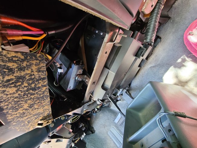

Hello, my heater core has gone out and I need to take the dash to access it. Has anyone done this before on the same model and know the steps that need to be taken? I have taken a photo of how far I have gotten before becoming stuck.

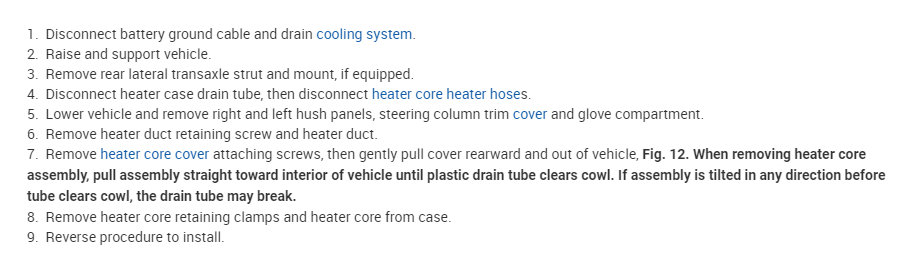

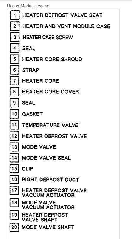

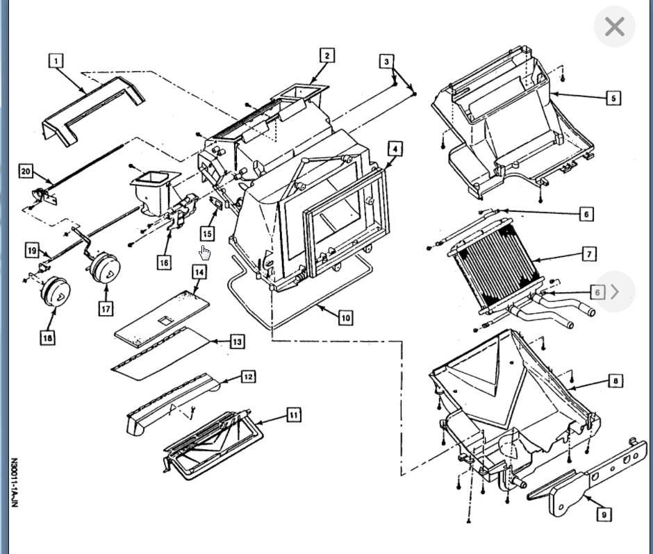

I am attaching the info from the manual on the heater core. Unfortunately it is not very detailed so I did an internet search and found some videos on some similar vehicles which could help so I would recommend looking at similar vehicles like a 1990 Grand Am.
Here is a guide that will help in more general terms:
https://www.2carpros.com/articles/replace-heater-core
Let us know if you need more info and we can see what we can dig up. Thanks

Oh my gosh, I can't thank you enough for the diagram! I will give it another shot today, take a peek at the videos you suggested, and let you know if I was successful or need more help.

Hey there! Just want to say thank you again for the diagram and what car to YouTube. That solved it for me (just needed to look for more screws), and I was able to get to the heater core no problem. You literally saved me months for a new car payment as I was ready to give up! You're the best!!!
