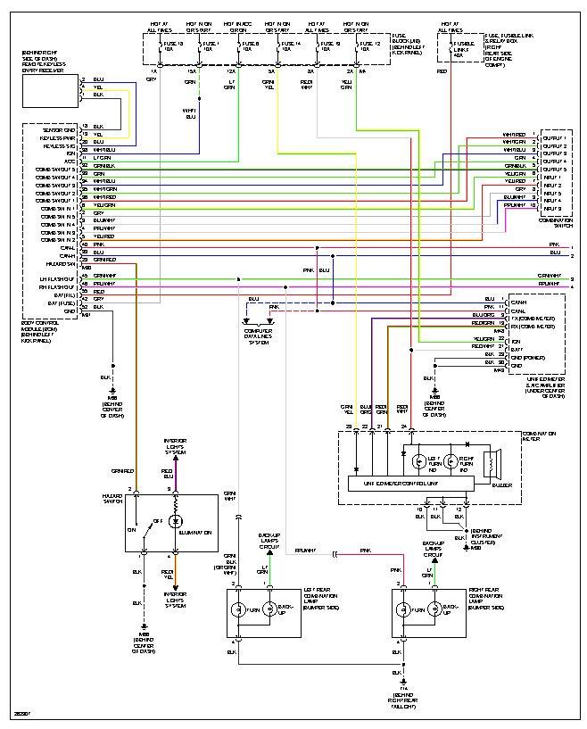

need the location of the fuse box and or fuse for the emergency flasher button
2007 NISSAN 350Z
95,000 MILES
STEVEN RAY FORTY NINE
no emergency flashers everything else works just fine so i need to know the location of the fuse to be replaced i have looked in both of the fues boxes one under the dash and the other by the battery with no success in finding the fuse to be replaced

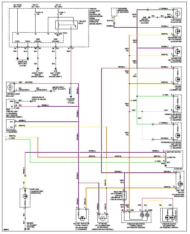

I have attached wiring diagrams for both the exterior hazard lights and the interior switch illumination. If you look at the fuses you will find a description of the location of the fuses. One possibility though is that your multifuntion switch is failing as the circuit runs through it and can cause the hazard circuit to fail while other functions such as turn signals still work. If you don't find a blown fuse that is most likely the problem.
