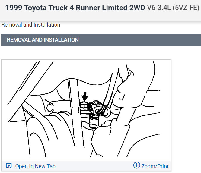

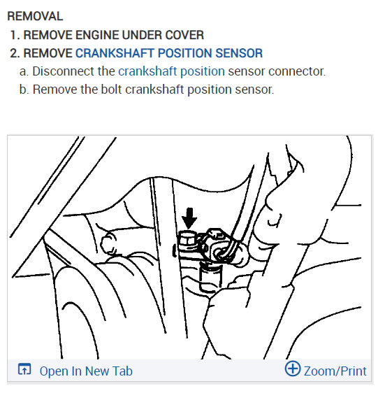

I would like if possible, some sort of engine diagram pointing out where the crank shaft positioning sensor is located on my vehicle listed above Limited model.
May 11, 2024 at 9:42 PM
  • 55,423 POSTS

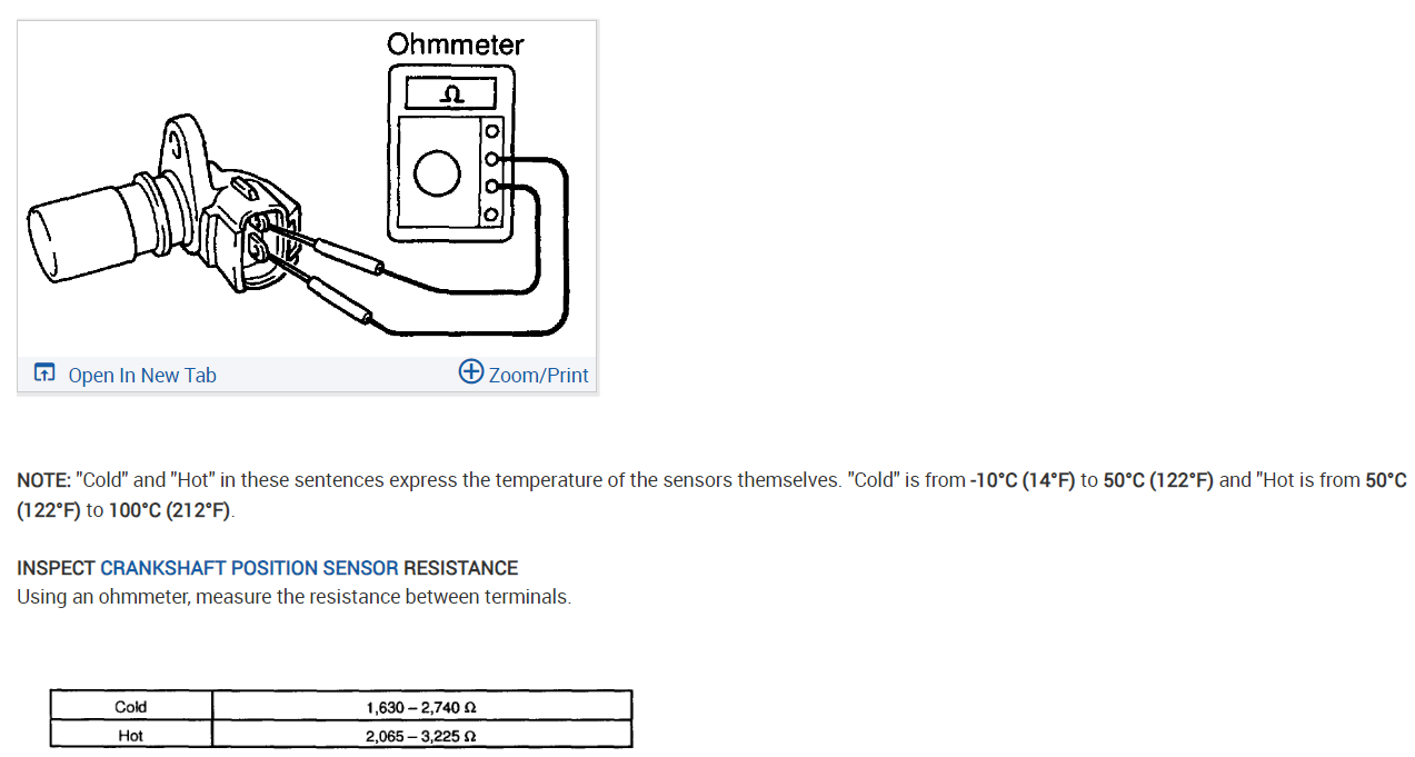

Sure, the crankshaft position sensor is located on the front part of the engine on the driver's side, here is what it does:
Crankshaft position sensor (NE signal) consists of a signal plate and pickup coil.
The NE signal plate has 34 teeth and is mounted on the crankshaft. The NE signal sensor generates 34 signals for every engine revolution.
The ECM detects the standard crankshaft angle based on the G signals, and the actual crankshaft angle and the engine speed by the NE signals.
Here is how to test the sensor as well, but keep in mind this test does not always determine if the sensor is good or not. Check out the images (below). Please let us know what happens.
