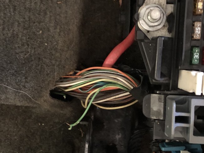

I have a high beam malfunction, and I have found a broken wire on the BCM harness. I need the BCM pinout and connector description/color reference to trace it down.

See how far you get with these.
The second and third diagrams are blown-up versions of the first one so they're easier to read. The fifth and sixth diagrams are the fourth one cut in half and blown up.

Thank you CARADIODOC! That's a huge help!
Jan 7, 2020 at 6:00 AM
HARPSTER
Problem fixed! It was the broken wire!

Dandy. Happy to hear you solved it. Please come back to see us again.
